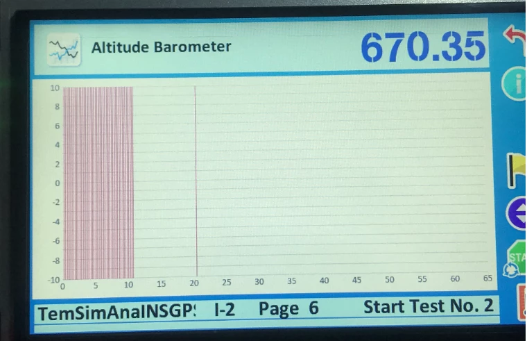

Hi all,
I just installed the new release 4.16 of TouchGFX and have a problem when using the Dynamic Graph widget:
I am using "Wrap and Overwrite" Behaviour and The Vertical Frontline activated. Line Width: 1
When adding points to the graph the Frontline is not updated correctly. Previous line positions are not cleared and stay visible in the graph until it wraps.
Furthermore: When calling "Graphik.clear(); Graphik.invalidate()" the Vertical Frontline is not cleared and flickers or stays permanently at the previous position until it is overwritten by new data points.
Any idea how to overcome this issue?

Hello Alexandre,
I can not run my project in the Simulator due to too much relation to my hardware environment.
Please see attached PNG for the issue.
Pink lines are the remaining frontlines in current graph, the separate pink line is the last drawn frontline of the previous graphics after clearing the graph.
BR / GS

As soon as the first screen is filled and the graph restarts at the beginning, the frontline is displayed correctly until the graph is cleared again. Then the last frontline position is visible (see first picture)

I think I reproduced the issue with the simulator. For me, the afterimages are created during the first round. The second round clears the afterimages and starting from the third round, the graph behaves correctly.
I will report to the dev team and I'll keep you updated.
