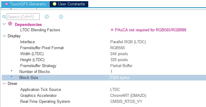

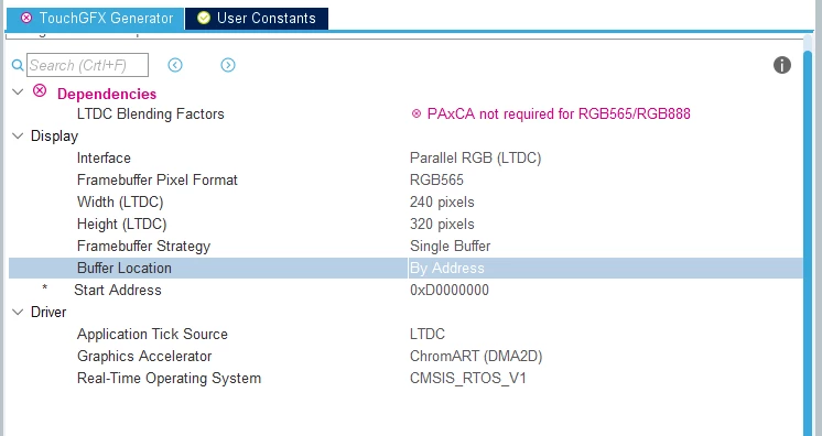

Hello.
I would like to know if there is some kind of manual to make everything work.
I tried to follow “Generator User Guide�? from here: https://support.touchgfx.com/docs/development/touchgfx-hal-development/touchgfx-generator
Using the following parameters:
I get the following error in both cases:

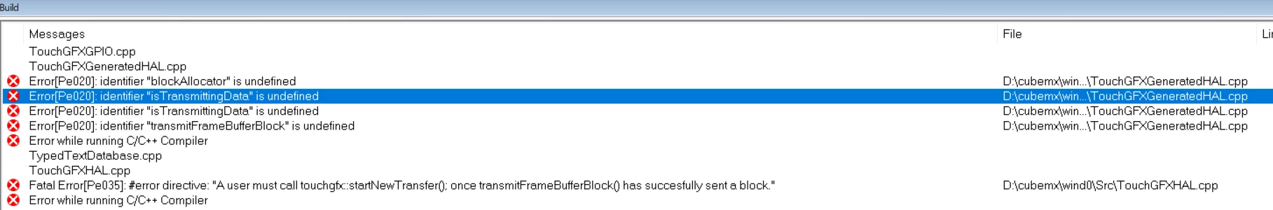

Fatal Error[Pe035]: #error directive: "A user must call touchgfx::startNewTransfer(); once transmitFrameBufferBlock() has succesfully sent a block." D:\cubemx\wind0\Src\TouchGFXHAL.cpp 40

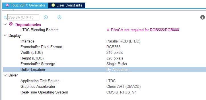

Using these parameters:
I get this:

PPS: I commented the following lines in the TouchGFXHAL.cpp and somehow SW was working but there was no picture in the board screen...
#error "A user must call touchgfx::startNewTransfer(); once transmitFrameBufferBlock() has succesfully sent a block."
#error "A user must implement C-methods isTransmittingData() and transmitFrameBufferBlock() used by the Partial Framebuffer Strategy."
If any other information is needed please let me know.
