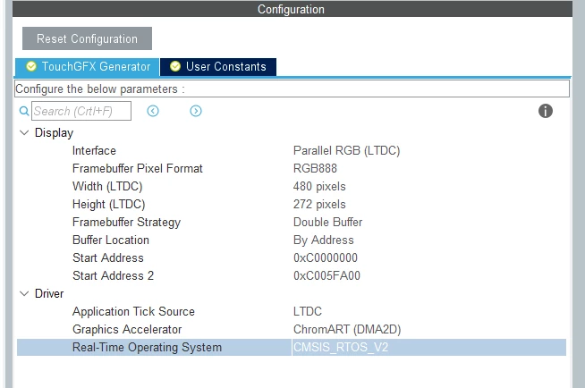

As per the touchGFX config menu, I am not sure what menu you are talking about, is this the one ?

Alexandre RENOUX
Visitor II
Aug 7, 2020 6:58 AM UTC
No the compilation problem has been resolved and now you have another problem :)
At least you are one step further now.
Yes I was talking about this config menu.
We noticed sometimes that CMSIS v2 does not work on some board but v1 works and vice versa. This is also probably why we haven't changed to v2 for this board.
Also, æake sure that the FreeRTOS v2 is well configured: For instance, your touchgfx task need a certain size to work correctly. Please have a look at the CubeMX config of the L4R9-Disco Application Template that uses CMSIS v2 for reference.
