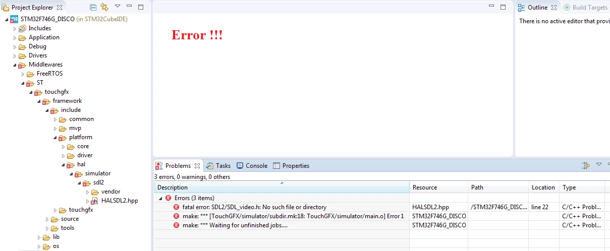

I have working on below setup:
Software Tool Chain:
STM32CubeMX 5.6.0
TouchGFX 4.13.0 Designer
STM32CubeIDE 1.2.0
Hardware:
STM32F746G-DISCO (Discovery Board)
I have created GUI on TouchGFX 4.13.0. worked fine on simulator and Discovery Board as well.
But I am trying import and open project in STM32CubeIDE 1.2.0.Imported Successfully . But Project not successfully compiled.
22:34:33 **** Clean-only build of configuration Release for project STM32F746G_DISCO ****
make -j4 clean
rm -rf *
rm: can't remove 'Middlewares/ST/touchgfx': Directory not empty
make: [makefile:151: clean] Error 1 (ignored)
22:34:36 Build Finished. 0 errors, 0 warnings. (took 2s.371ms)
22:34:40 **** Build of configuration Release for project STM32F746G_DISCO ****
make -j4 all
In file included from ../TouchGFX/simulator/main.cpp:1:0:
../../Middlewares/ST/touchgfx/framework/include/platform/hal/simulator/sdl2/HALSDL2.hpp:22:10: fatal error: SDL2/SDL_video.h: No such file or directory
 #include <SDL2/SDL_video.h>
compilation terminated.
make: *** [TouchGFX/simulator/subdir.mk:18: TouchGFX/simulator/main.o] Error 1
make: *** Waiting for unfinished jobs....
"make -j4 all" terminated with exit code 2. Build might be incomplete.
Please Check attachment...and update ..
I have add/use to USB Mass Storage Stack , SDMMC with FATFS with TouchGFX GUI .
Karan
Best answer by Martin KJELDSEN
Hi Karan,
Your problem is that CubeIDE is trying to compile SDL2 files (simulator). Newest version of CubeIDE and latest version of the AT should not have this issue. Can you verify?
/Martin
/Martin

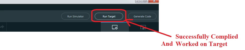

Karan 123
Karan 123Author
Senior
April 30, 2020
Thanks for response .. But Problem already solved with Below Toolchain..
STM32F746G Discovery Kit v3.0.1
STM32CubeMX 5.6.0
STM32CubeIDE 1.3.0
Anyway Thanks..
