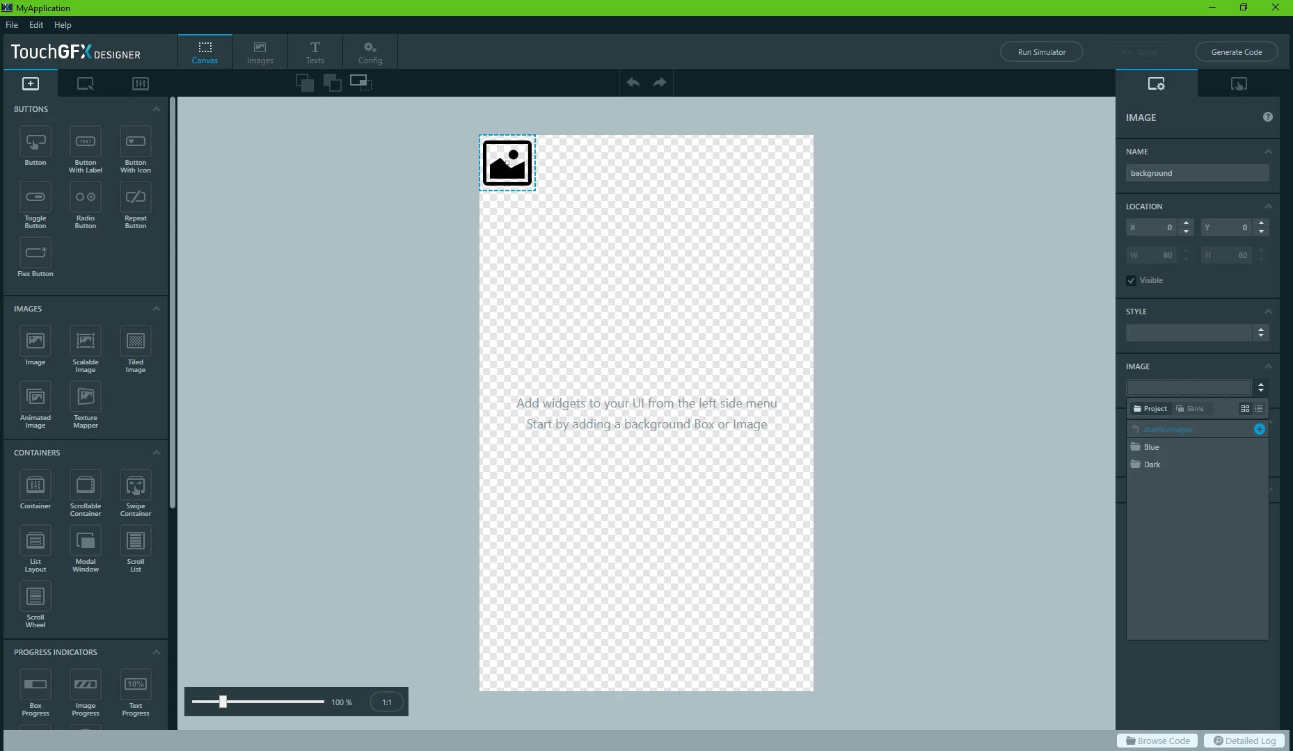

I am using TouchGFX 4.12. Here is what i have done and what is the problem;
  • Created new project from CubeMX.
  • Enabled TouchGFX from CubeMX.
  • Opened TouchGFX and added a image object.
  • Imported png images to the project path via image object's image property.
  • Tried to select one of the image that i just imported.
Below I showed what i am talking about. By the way, my CubeMX version is 5.3
I am not using CubeMX 5.4 because, i can not compile the project successfully when i create from CubeMX 5.4.
So what is the problem here? Why i can not add images to the objects?

Looks like you've selected the skins tab. Try going to the "project" tab ?
/Martin
