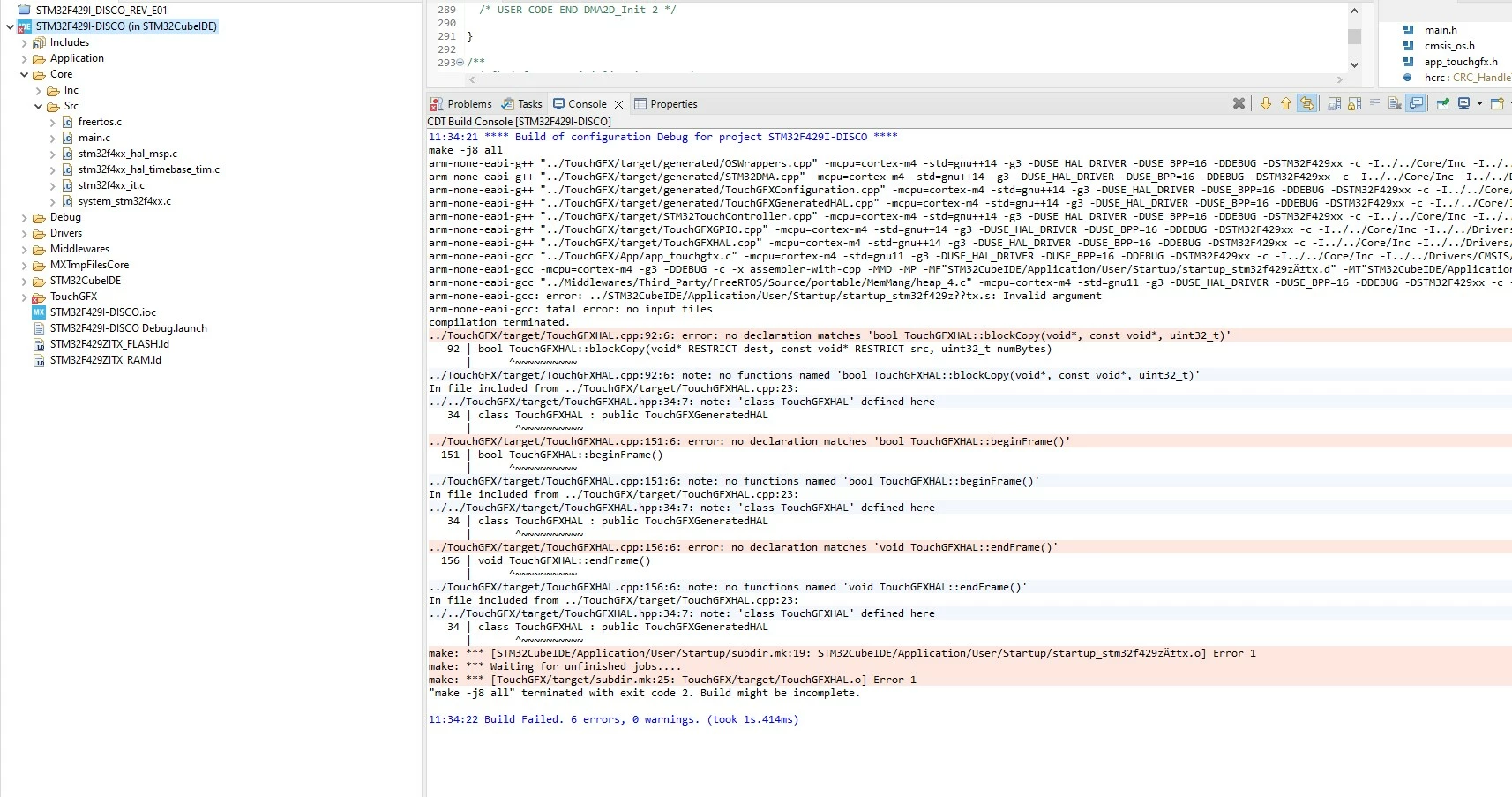

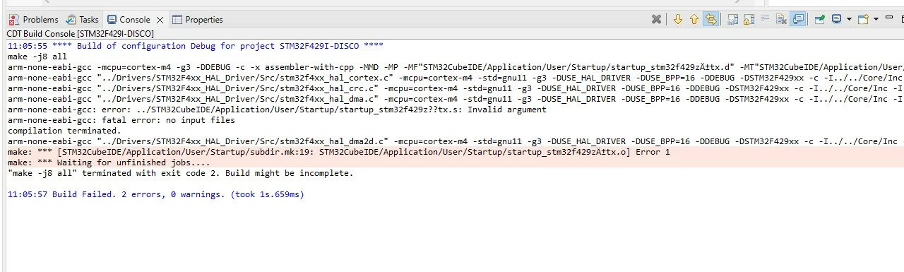

I am using TouchGfx to generate code for CubeMx and STM32IDE. But it returns error as seen in the image.
I tested it with different versions but in the end i couldnt get successful build.
Could you please tell me how to cope with it.
When i pass to IDE program and build it returns error like these;
******************************************************************************************IDE_error2.jpeg
arm-none-eabi-gcc: error: ../STM32CubeIDE/Application/User/Startup/startup_stm32f429z??tx.s: Invalid argument
arm-none-eabi-gcc: fatal error: no input files
compilation terminated.
../TouchGFX/target/TouchGFXHAL.cpp:92:6: error: no declaration matches 'bool TouchGFXHAL::blockCopy(void*, const void*, uint32_t)'
   92 | bool TouchGFXHAL::blockCopy(void* RESTRICT dest, const void* RESTRICT src, uint32_t numBytes)
../TouchGFX/target/TouchGFXHAL.cpp:92:6: note: no functions named 'bool TouchGFXHAL::blockCopy(void*, const void*, uint32_t)'
In file included from ../TouchGFX/target/TouchGFXHAL.cpp:23:
../../TouchGFX/target/TouchGFXHAL.hpp:34:7: note: 'class TouchGFXHAL' defined here
   34 | class TouchGFXHAL : public TouchGFXGeneratedHAL
../TouchGFX/target/TouchGFXHAL.cpp:151:6: error: no declaration matches 'bool TouchGFXHAL::beginFrame()'
  151 | bool TouchGFXHAL::beginFrame()
../TouchGFX/target/TouchGFXHAL.cpp:151:6: note: no functions named 'bool TouchGFXHAL::beginFrame()'
../TouchGFX/target/TouchGFXHAL.cpp:156:6: error: no declaration matches 'void TouchGFXHAL::endFrame()'
  156 | void TouchGFXHAL::endFrame()
../TouchGFX/target/TouchGFXHAL.cpp:156:6: note: no functions named 'void TouchGFXHAL::endFrame()'
make: *** [STM32CubeIDE/Application/User/Startup/subdir.mk:19: STM32CubeIDE/Application/User/Startup/startup_stm32f429zıtx.o] Error 1
make: *** Waiting for unfinished jobs....
make: *** [TouchGFX/target/subdir.mk:25: TouchGFX/target/TouchGFXHAL.o] Error 1-
When I erase the part :"TouchGFXHAL::" it returns this build error.
    1 reply

    Hello @embedded_eng ,
    Based on the errors, it appears that the IDE fails to correctly connect TouchGFXHAL.cpp and TouchGFXHAL.hpp.
    These files are provided by TouchGFX when you select a board from the list of available boards and then you generate code through the TouchGFX designer.
    Are you using a custom board with STM32F429?
    Could you please check that the three functions mentioned in the errors are defined in TouchGFXHAL.hpp?
    Thanks
