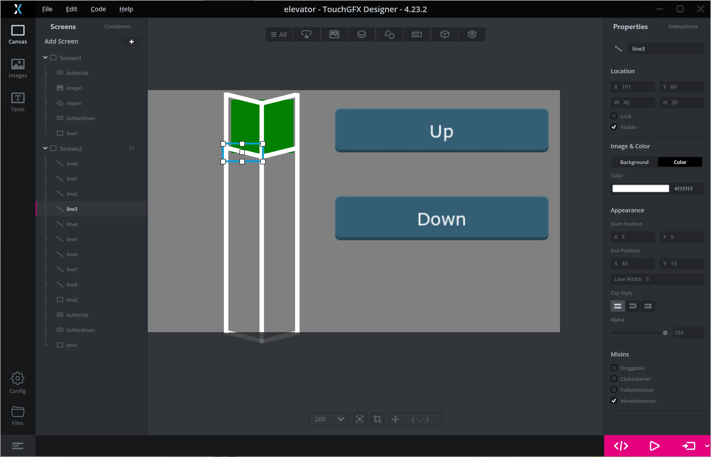

Hi Team,
I have a requirement to create an elevator animation based on user input.
I have a 3D image representing a single floor, and I am using it in a container to create a scroll list for multiple floors. However, because of the 3D image, there is a gap between the floors, which is causing issues.
Please find the attached images showing the actual output and the desired output. How can I manage this gap effectively?
Thank you.

    Lead III
    Jun 6, 2024 7:58 AM UTC
    It looks like a vector image with a few straight and a few diagonal lines. You can use inkscape to draw the vector image and then export it as svg or as png. So a single image.
    Another solution is to use the line object in TouchGFX. The floors are 3 vertical lines in total and 2 diagonal lines per floor (+ 4 extra for top floor).

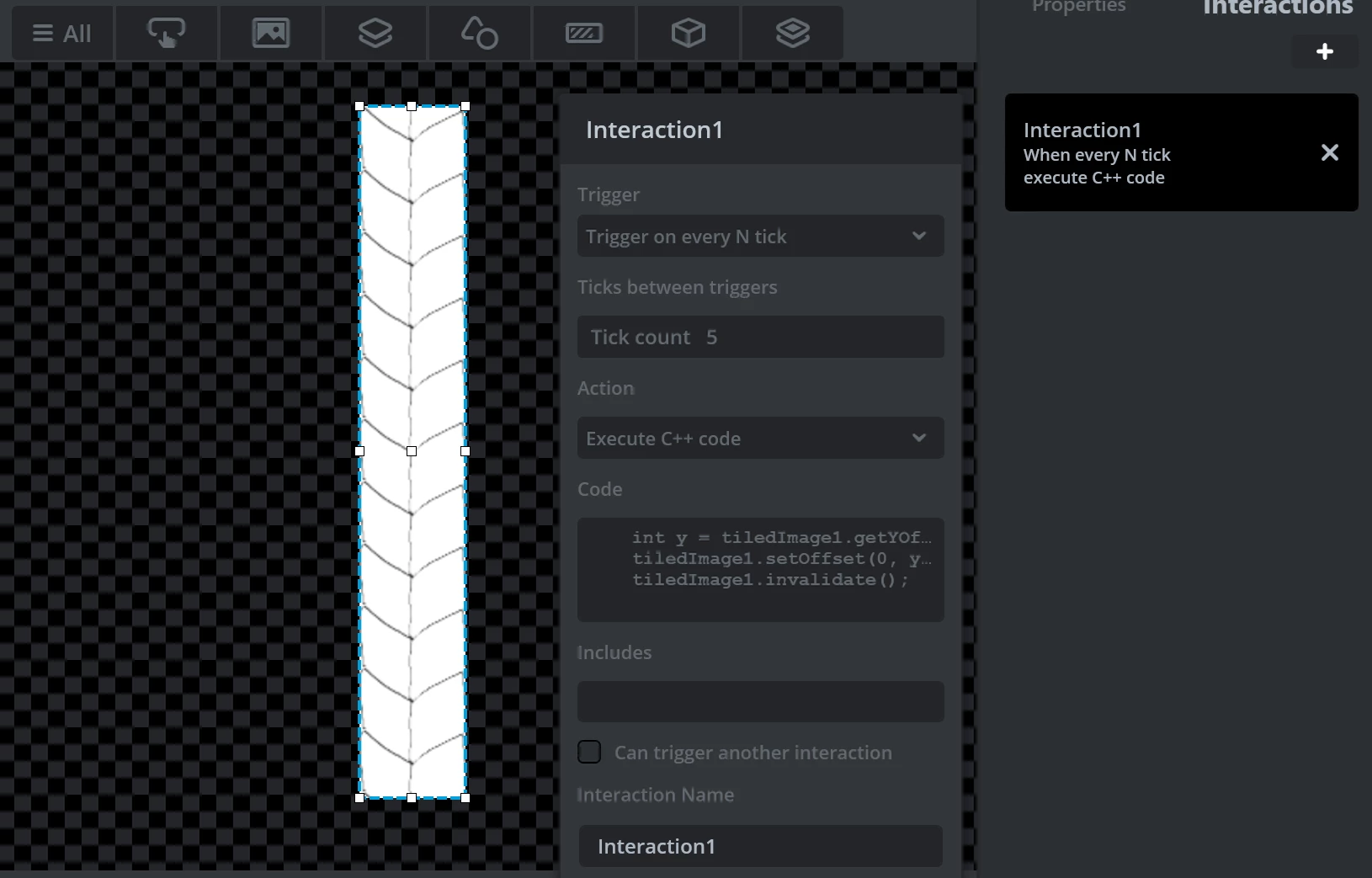

    MM..1
    Jun 6, 2024 2:26 PM UTC
    My tip start with tiled image + Special image on top + cabin image ...
    read Tiled Image | TouchGFX Documentation

    Hello @APate.18,
    You cant put negative margin in Designer, a simple solution is to directly edit the project file (myproject.touchgfx).
    The steps:
    1) Put margin to a value above 0 (Or add manually in the project file "itemMargin" in component->scrolllist)
    2) Generate the project
    3) Edit  "ItemMargin" in the project file
    4) Go back to designer, accept to reload.
    tweak the margin value with steps 3-4 until you find the one you need.
    I hope it helps,
    Regards,
