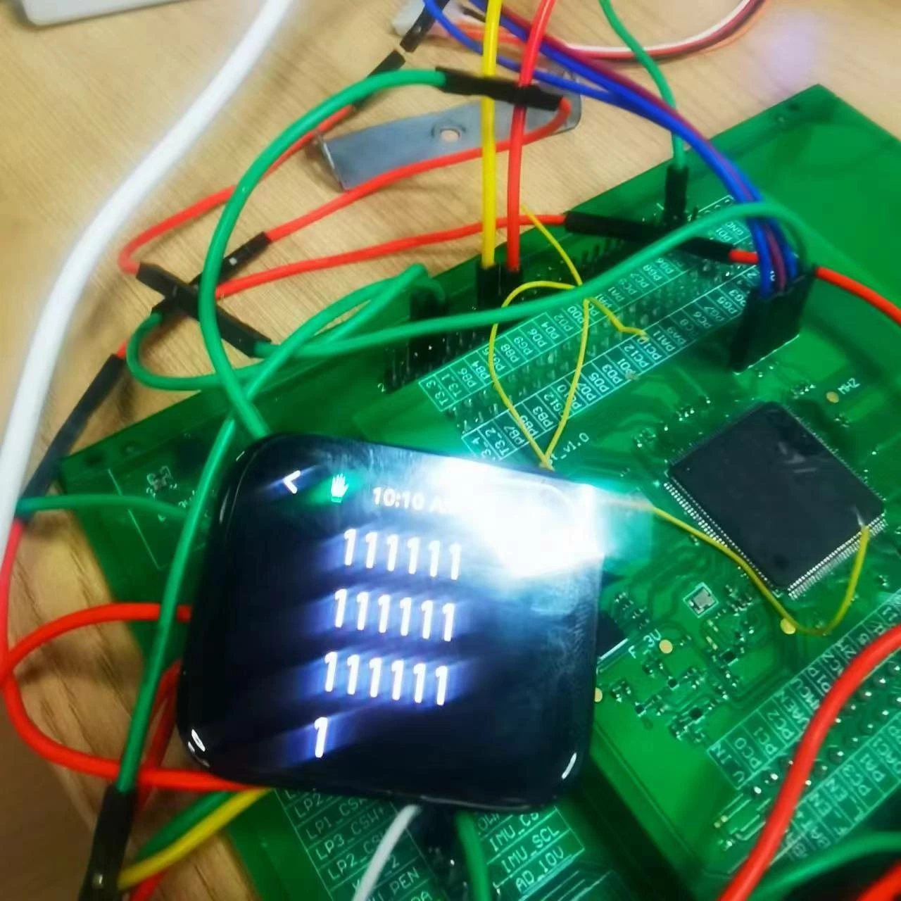

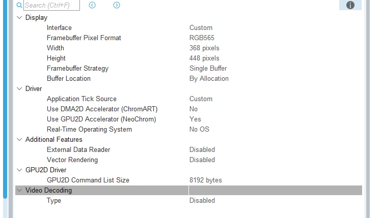

touchgfx 4.22.1 When using GPU2D for rendering the textArea component in stm32u5a9, there is an issue with the content not being rendered, but the images are not affected. There is a problem with rendering fewer characters when using scrollWheel in combination with the textArea component,
but if the image is displayed before updating the textArea, there are no issues with the textArea component.
