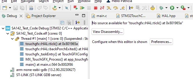

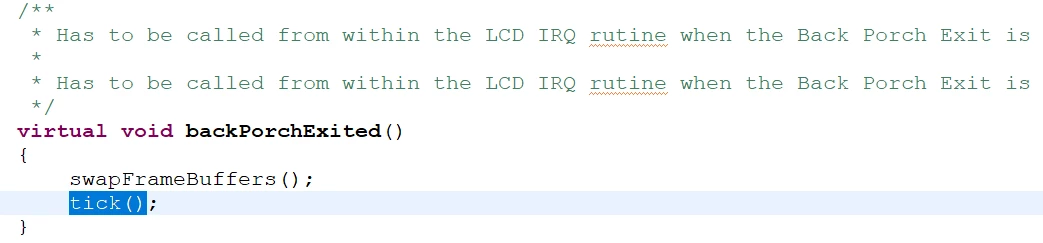

Looks like I am actually always getting a HardFault upon touching the screen (not just when I enable DCACHE). If I run my debugger and set my breakpoint within sampleTouch the I2C Receive works and the X_Touch and Y_Touch coordinates are read successfully, but once I step past that function I see a "No source available for touchgfx::HAL::tick()" then it enters the HardFault loop.
This tick() looks to be called from the HAL.hpp backPorchExited() function
When I do not touch the screen, and set my breakpoint here this tick() function gets called periodically and runs without issue. Do you have any suggestions on what could be causing this? I've been looking around the forums and haven't found anything that has helped.

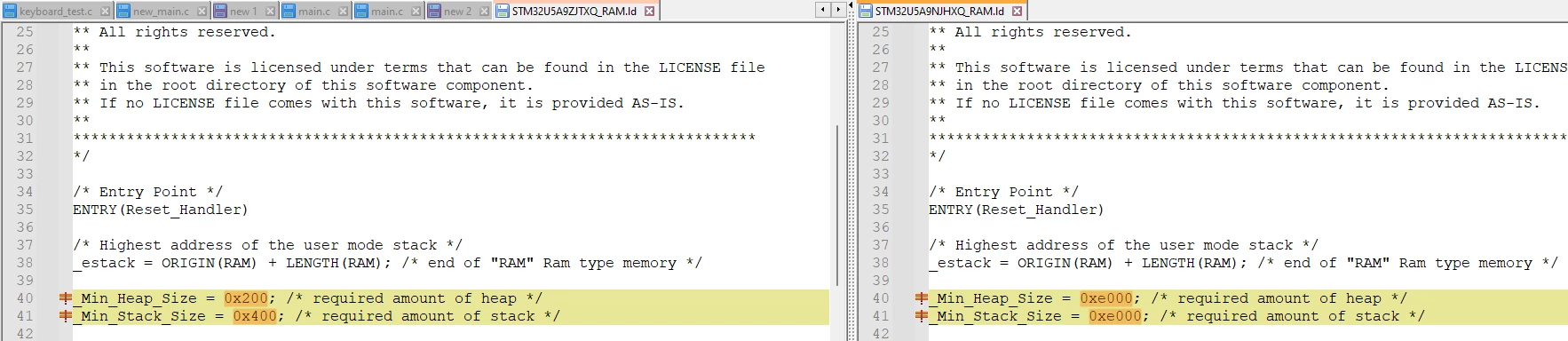

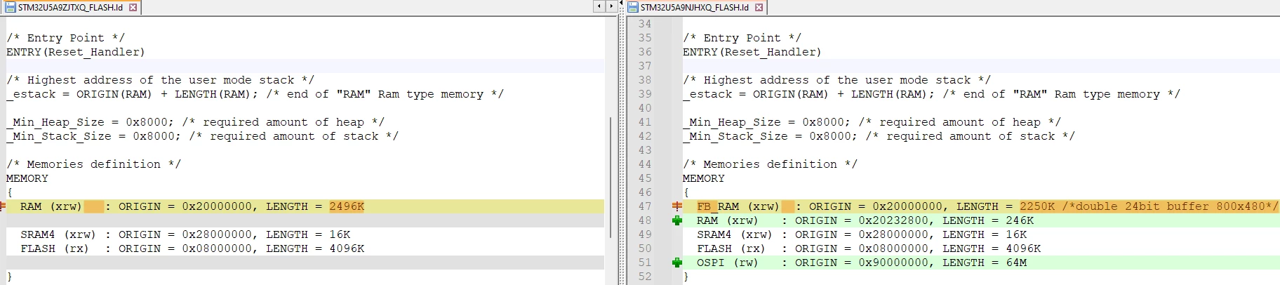

One of the things I missed in getting my CubeMX generated project ready to interface with TouchGFX were the STM32U5A9NJHXQ_FLASH.ld and _RAM.ld files
^ my custom PCB project's FLASH.ld file is on the left and the working demo project on the right. Was missing some configuration for the frame buffers
20250214_ramLDFiles.png ^ ram.ld file was missing larger heap and stack size
I copied over the differences (hoping the difference between the NJHXQ and my ZJTXQ doesn't impact the flash and ram... does it?). The system now responds to my on-screen button presses; however, the screens have now gone black. Only the Box elements are showing up.
