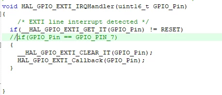

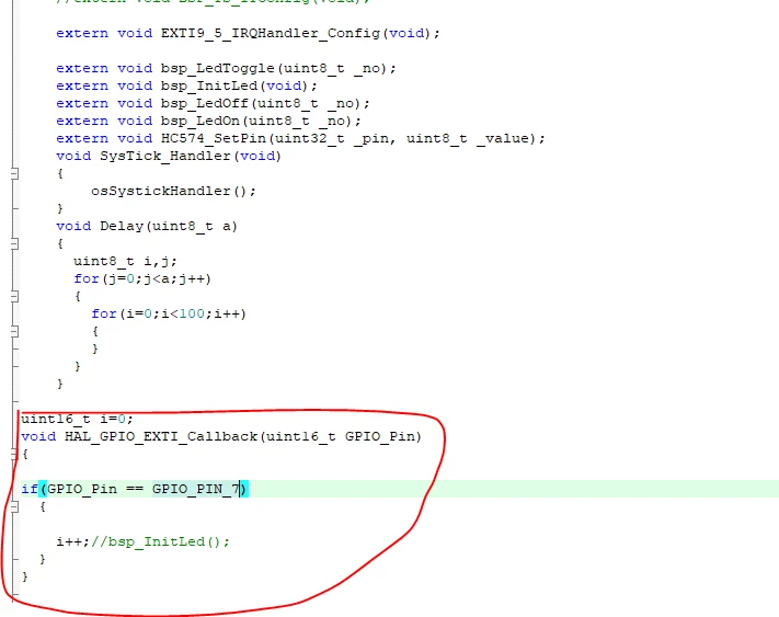

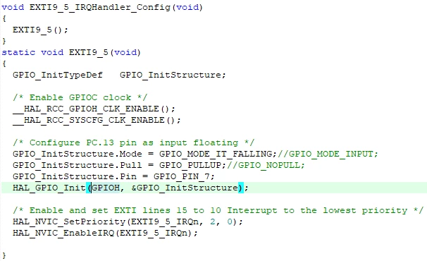

Hi professors,
I am using STM32H743 with my development board,and I am trying to build a Interrupt for the touch function,codes are down below.
By the way, the code is generated by TouchGFX and Board STM32H743I_EVAL.
Pin defined
Interrupt function in C++ file
I tried a lot but it didn`t work.
Is there any one can help?
Thank you!

Check if you have an Interrupt signal on the pin?

Yes,I am trying to build it with interrupt function,but I face the problem is that in Debug Mode didn`t detect where I touch then run into my Interrupt function.
Is it make the wrong way about build the function?
I have search many method,but was`t solved.
Hope you can help me!
