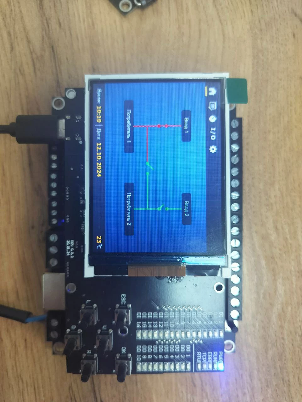

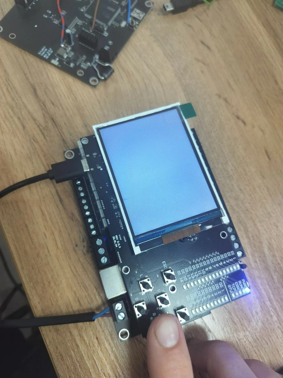

I have a simple project with multiple screens. Physical buttons are configured to scroll between screens. When the device boots, the first screen is displayed correctly, but when you try to switch to the second screen, the display turns gray and the device freezes. The project will be moved from STM32F407ZET6 to STM32H723ZGT6. Tell me what could be the problem?

My device does not have a touch screen.
All control is done using physical buttons. The button handler is moved to separate C files - button_handler.c and TouchGFX_ButtonController.c
The button handler, I think, works correctly, because if you set a breakpoint in the file on the condition of the corresponding button and click on it, it will stop at this point and all assignments will be executed. Also, after this, the device seems to try to switch the screen, the screen flickers, and then it turns gray. And before, my code worked on STM32F407ZET6, but errors appeared when migrating to STM32H723ZGT6. I'm guessing that I have some kind of error in the project configuration.

I imported the GUI according to your instructions. For a while, for testing, I left only the button with key 3 - switching screens to the right. The problems have not been resolved. I am attaching two photos: a photo of the first screen and the second one that did not load.

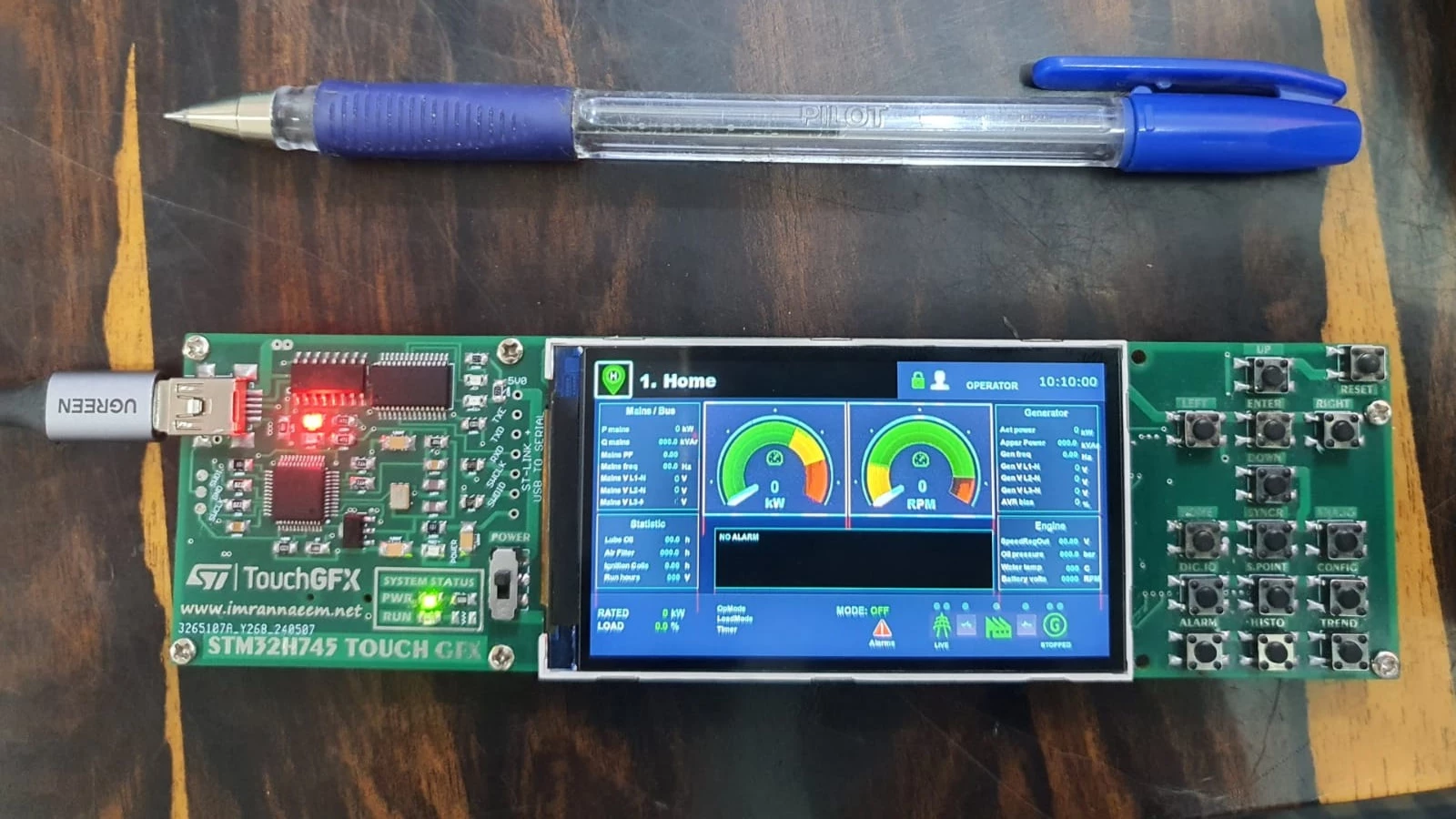

 Hi alexeyskosnyagin .
I have been playing with multiple screens with out any problem.
check my reply in following old post , in which I tried to explain keys handling .
https://community.st.com/t5/stm32-mcus-touchgfx-and-gui/toughgfx-change-screen-from-button-virtual-function/m-p/580148#M34229
As per my understanding , you have done some part correctly , but transitions between screens need interrupted base hardware keys .
here is my latest TouchGFX Board with STM32H745 & 2.95" , 854X480 TFT.
The board has hardware keys with MCP23S17 SPI IO Expander with Interrupt.
I have 9 different screens till now in this tiny TouchGFX experiment.
I will look in your codes and will revert back.
