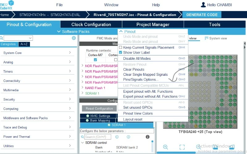

If you created your project from TouchGFX Designer by selecting your board+display combo, then you can try to open the STM32CubeMX project (.ioc file) and click again on "Generate code" (make sure to have the right toolchain selected [STM32CubeIDE for TouchGFX Designer] and do NOT generate under root).
Can you tell us what board+display you are using?
If this comment solves your problem, I invite you to select it as "best answer".
Regards,
Gaetan GodartSoftware engineer at ST (TouchGFX)
AzizAuthor
Aug 8, 2024 12:00 PM UTC
I open cubemx and i haven't access to it .Also the type of card selected isn't the mine my card is nucleo stm32h7a3ZITQ

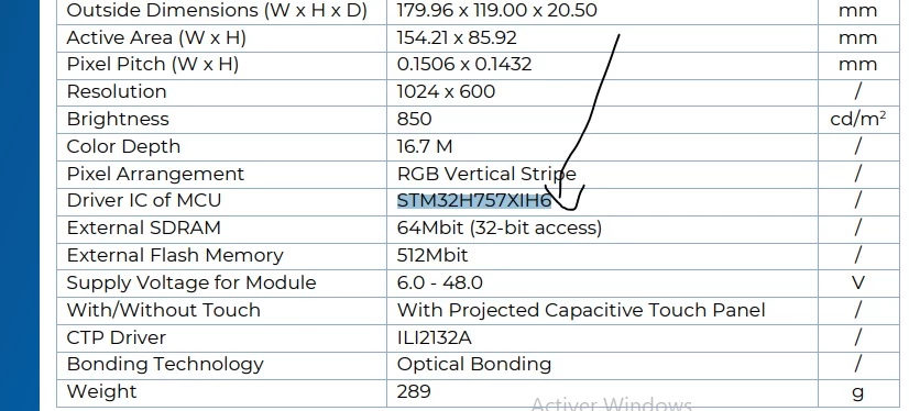

the display i use is Riverdi_70STM32H7 i have riverdi 7"

after i deleted  libjpeg-8.dll, SDL2.dll, SDL2_image.dll, simulator.exe and i didnt generate or simulate the code again i run target direct and the error message at first appeared
Now i change the version of STM32CubeMX 6.12.0 to 6.5.0 and the IDE from 1.16 to 1.8.0 and i ll try it

Since you use a Riverdi board, here are the steps to be able to flash your design on your board:
  1. Open TouchGFX Designer (hopefully the latest version [4.24.0])
  2. Click on "Create new" or "New"
  3. Select "By partners" (1) you can also write "Riverdi" in the search bar
  4. Select the board you are using. In your case the Riverdi_70 as you use 7 inches screen. (2)
  5. Make sure that your board reference is available for this TBS. (3)
  6. Finally, you can create a project. (4)
Then you can import the GUI you previously created by clicking on "Edit" => "Import" => "GUI".
If you have done those steps and you get the error messages mentioning flushline and DecompressorRGB, simply open your folder, open the STM32CubeMX file (.ioc) and click on "Generate code" (make sure to use the correct toolchain such as STM32CubeIDE for STM32CubeIDE or TouchGFX Designer).
Then you can flash again and the issue will be gone.
