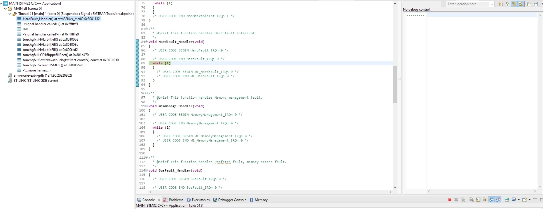

hello,
I Have linked the Touch GFX folder from another project and the code got compiled while running and  Debug I am gettingtouchgfxerror.png this error.

In STM32CubeIDE, go to Debug Configurations > Startup > Enable "Fault Exception Handling".

Linked to the TouchGFX library created for the same MCU part number?
Feb 14, 2025 5:11 AM UTC
The linked touch GFX  folder is created for the same MCU.

hello ,
I have linked touch GFX folder  to my project from another project its getting compiled but during run its showing hard fault   I will attach the screenshot please help me to overcome this issuetouchgfxerror.png

Hello @jijomathew ,
You should try debugging your application as suggested by @Andrew Neil .
By the way, I would not recommend to link your TouchGFX folder from another project because when you generate code in TouchGFX designer it's pointing to a specific folder (STM3CubeIDE folder) inside your application.
See below the lines when you generate code in TouchGFX Designer :
jijomathewAuthorBest answer
Feb 21, 2025 6:34 PM UTC
  • Yes i was able to resolve the issue, last time there was a mismatch in the project configuration which I was trying to link,
