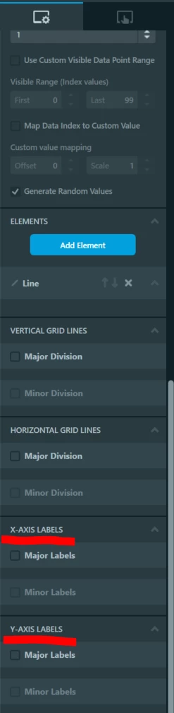

I'm using Dynamicgrapgh widget in TouchGFX to represent the sensor values graphically, i want to display the X and Y axis labels. I'm unable to get the labels on display UI even though i have enables Horizontal and vertical axis labels. Also how to write a function to update the sensor values on graph. Suggest me a solution

Could you share a screenshot of your graph configuration in TouchGFX Designer ? In the right tab there is an option to set the text for the label, you also have to set the "Graph area margin" section.

Could you share screenshots of your issue ? It will help us visualize what you are trying to do.
Concerning the graph, have you looked at the UI template "Dynamic Graph Example" ? What you need to do is replace the random values generated by the values from your sensor. This video guide from Jesper may help you understand how to work with it.

I have gone through that UI template, i tried the same way. Only thing x and Y axis labels are not displaying.
