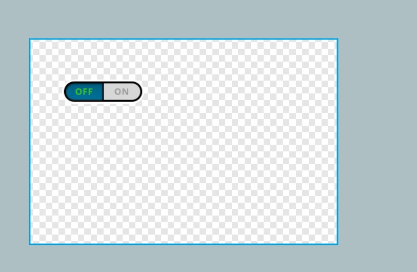

i'm trying to use a touchgfx with a capacitive touch. I have wrote a simple demo example. During the simulation i can switch an on / off a switch button just clicking with the mouse on it.
In my hw integration i'm using the sampleTouch to give the coords to the library. I have checked the coords and they are right but i didn't see any effect on the screen element. it seems that the touch event is not properly caught by the library.
Thank you
BR

So you confirm that when debugging, every time you touch your screen, your if statement is true and the program executes what's inside the if, meaning the retrieval of the coordinates and these coordinates are correct, right ?
Because in this case, the touch should be caught by TouchGFX for sure.
What board are you using ? I guess that you are using a custom display.
/Alexandre

Yes. every time i pass the right coordinates to the library and they are the button area.
I'm using a custom board with a custom TFT.
I don't know if the reason is the implementation in touchgfx designer. But with the simulator that button works fine.
