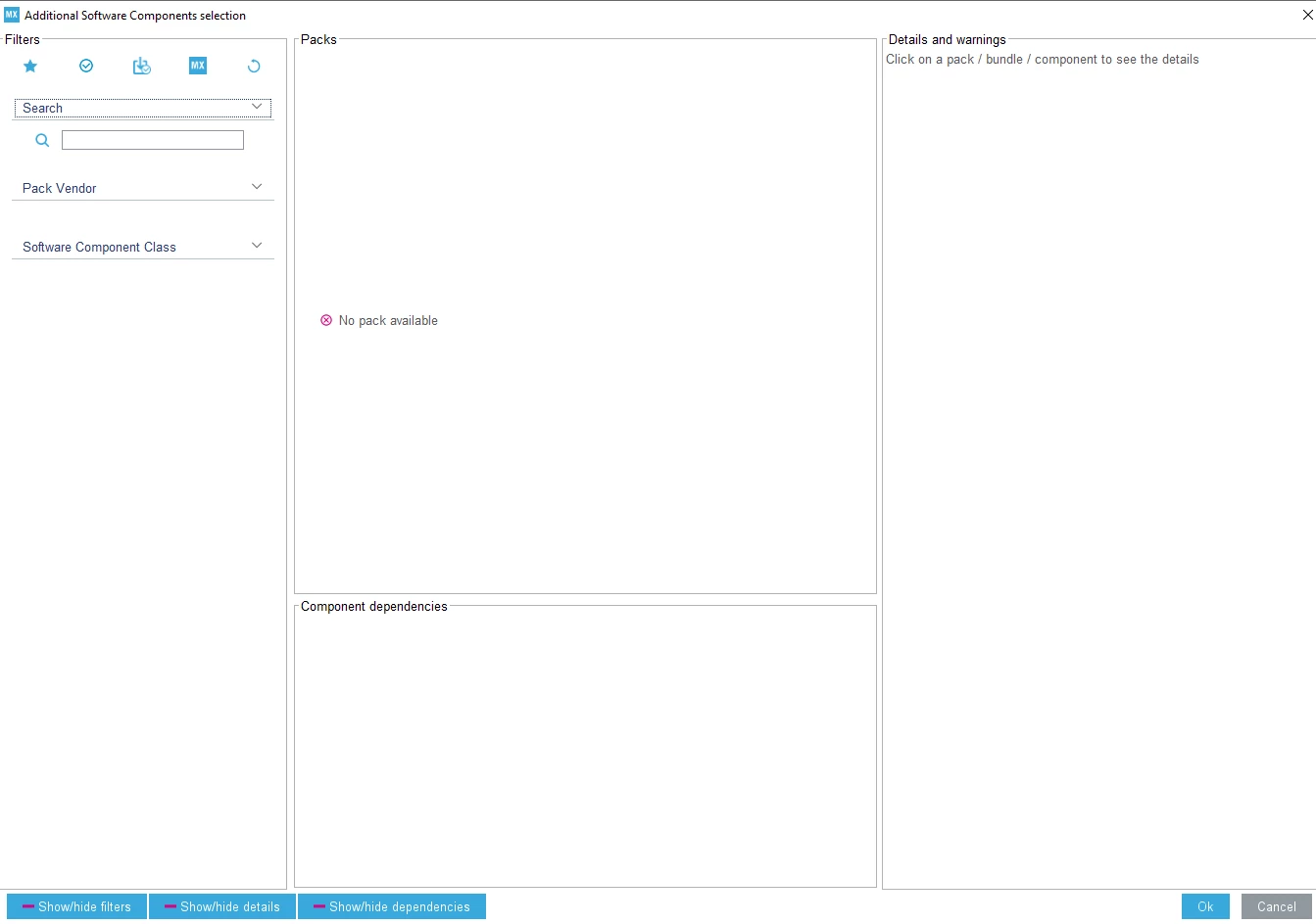

Touch GFX additional software window is empty

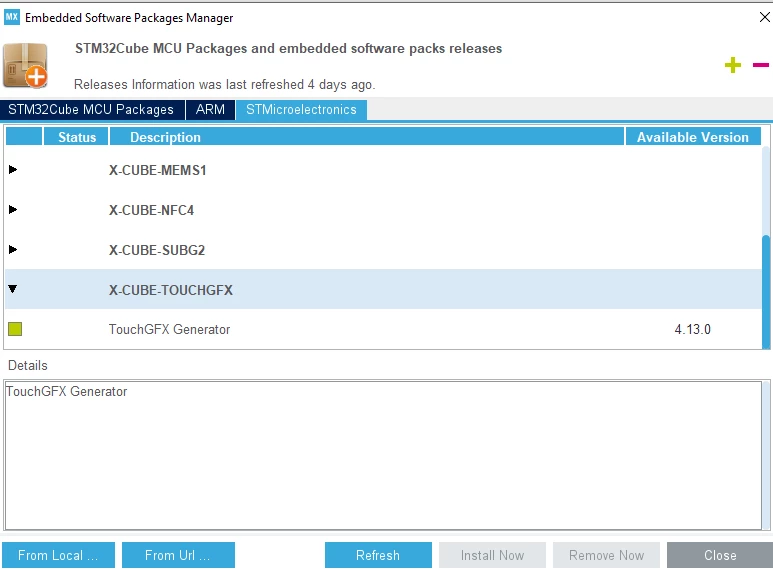

Hello I am trying to use Touch GFX. In CubeMX I installed the related software pack:
When I open the additional software part there is no option I can enable Touch GFX, it is simply empty:0690X00000Bwig1QAB.png
How can I enable it from CubeMX? Thank you beforehand.

If you're using a dual core like H747, then no additional software is available from CubeMX - Which MCU is this?

Yes it is dual core: STM32H747XIHx.

Sorry, CubeMX is blocking any additional software from being used in this case :( I'm not sure when that'll change or the reason for doing so outside of the dual cores being really complex.
