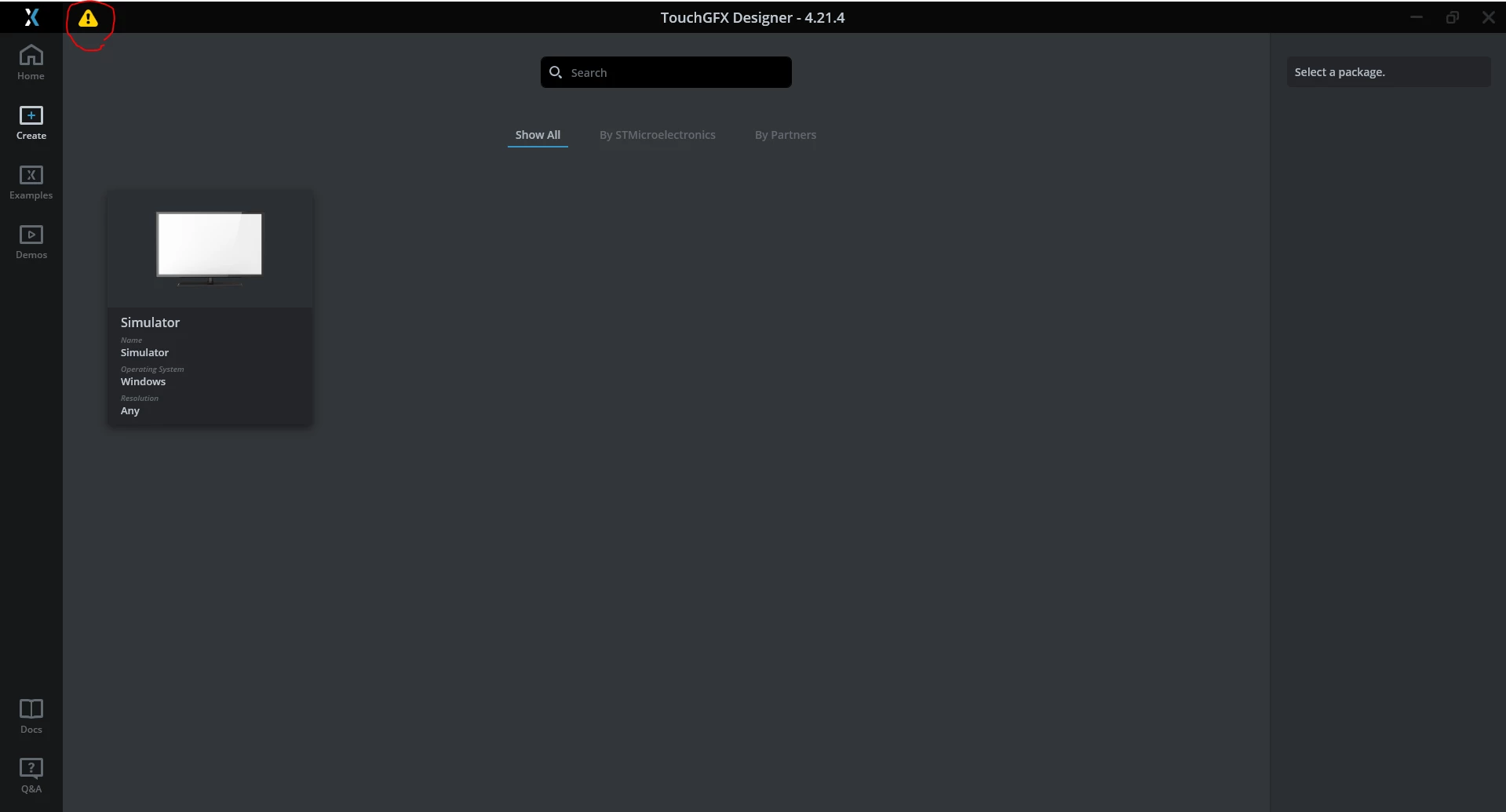

Touch GFX 4.21.4 "You are not connected to the internet"
I'm currently experiencing an issue with my Touch GFX 4.21.4 interface, as it keeps displaying an alert stating that I'm not connected to the internet. I have tried different solutions on my side, such as checking my internet connection and using other devices, but the problem persists. I would like to know if there are any specific configurations or settings that I should be aware of to ensure the proper functioning of the Touch GFX. If anyone has encountered a similar issue or has any suggestions to resolve this problem, I would greatly appreciate your help. Thank you in advance.

Hello @AHana.2​,
This is unfortunately a persisting and recurring issue with TouchGFX.
We are currently working on fixing it.
One work-around that usually work is to close TouchGFX Designer, open an Internet Explorer page (or Microsoft Edge as it is called now), navigate to a website (e.g. google.com) and re-open TouchGFX Designer.
That works most of the time, but if it doesn't, the issue usually disappears after some hours.
Sorry for the inconvenience,
/Yoann
