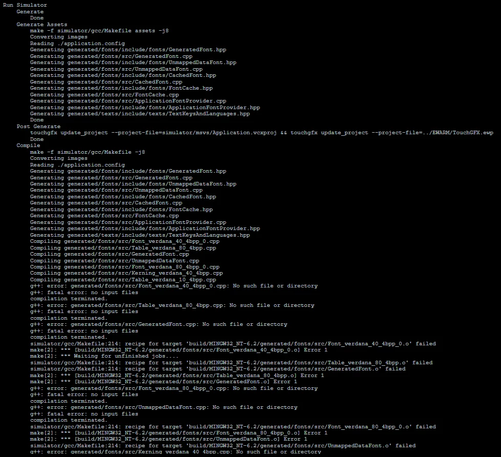

I have been having issues with Touch GFX bricking my project during code generation. It starts out working but at a later point it starts generating invalid code. An example is that it starts generating a touchgfx::GraphElementLine without a variable name. Another example is it cannot find certain fonts cpp files during compilation. I can e.g. fix the GraphElementLine by deleting my dynamicGraph and creating a new one. The font issue I haven't found a solution for. Anyone else experienced this and know how to fix it?

I have met the same issue regarding "cannot find certain fonts cpp" with TouchGFX 4.16.
I just followed the official tutorial 2 step by step.
The error occurs after adding the range "0-9" in the "Wildcard Ranges" column for the Default typography.
 Compiling generated/fonts/src/Table_verdana_10_4bpp.cpp
 g++: error: generated/fonts/src/Font_verdana_40_4bpp_0.cpp: No such file or directory
 g++: fatal error: no input files
 compilation terminated.
 g++: error: generated/fonts/src/Table_verdana_80_4bpp.cpp: No such file or directory
 g++: error: generated/fonts/src/GeneratedFont.cpp: No such file or directory
I checked the files under generated/fonts/src/ dictionary, all above mentioned files exist.
I did the same tutorial 2 with TouchGFX 4.15, it works fine.
I also compared generated files from two different TouchGFX Designer, they are identical.
​ My board : STM32H747-DISCO

The application templates for the H747 boards are a bit apart from the others because the ATs are quite old now and are not based on STM32CubeMX (because CubeMX does not support dual cores and additional softwares). I have reported the issue but I) can only advise to continue using 4.15 until this is fixed. (maybe look at the makefile in the gcc folder to see the call for those files)
