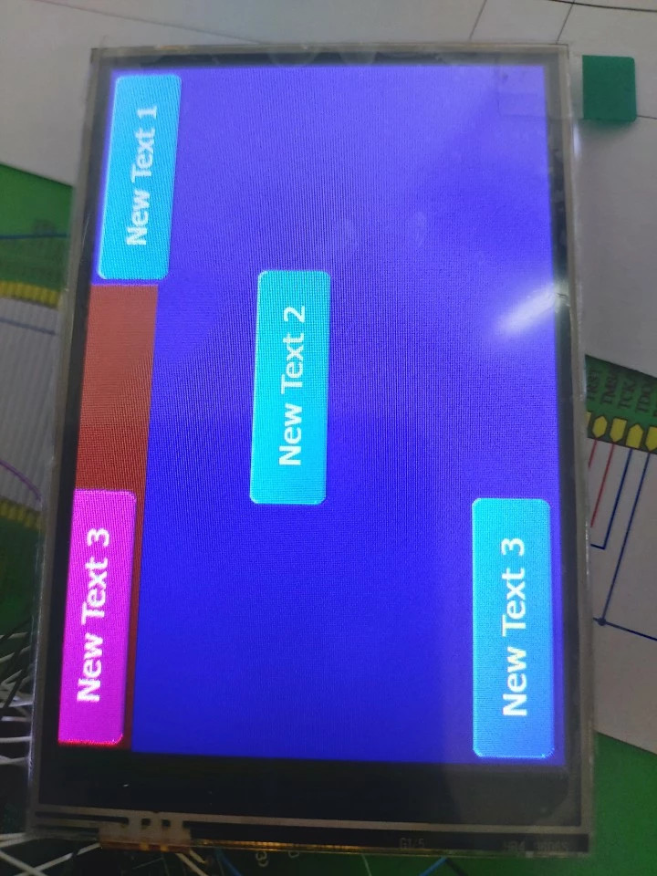

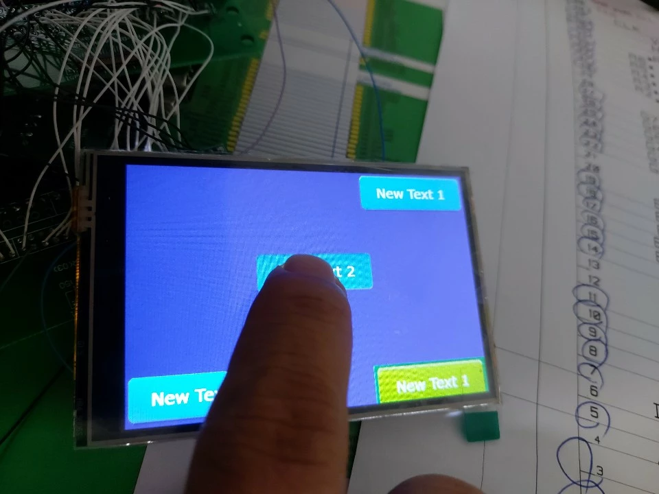

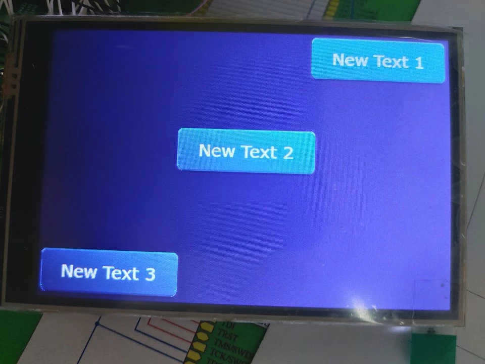

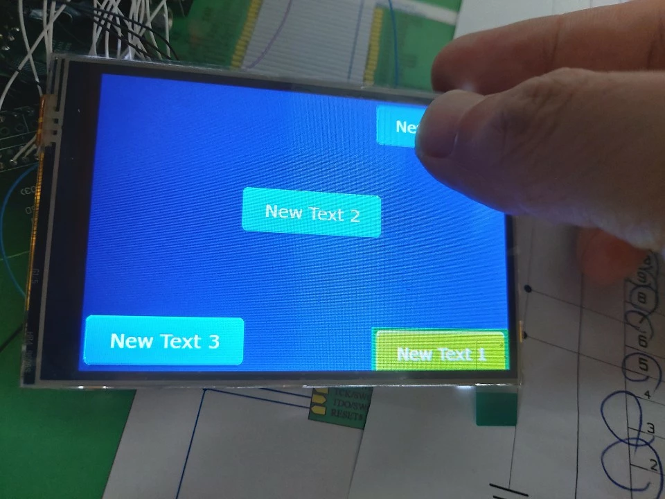

touch action problem
  1. Initial screen
  2. Screen when the button 1 is pressed -> button 1 label pop up
  3. Screen when​ the button 1 is released -> top area of display is strange
  4. Screen when button 2 is pressed -> button 1 label pop up
  • Button 3 does not touch -> bottom area of display don't touch
What did I do wrong?

Romain DIELEMAN
Aug 27, 2020 6:29 AM UTC
Could you elaborate a bit more what you are trying to do and how you programmed everything? Did you use the Interaction tab in TouchGFX Designer? We need more details to understand the issue and how to solve it. Maybe share more photos/code or the project.

pabian
pabianAuthor
Aug 31, 2020 12:02 AM UTC
Here's what I did:
  1. create STM32CubeIDE 1.4.0 project with STM32429I-EVAL template (FW_F4_1.25.0)
  2. create TouchGFX 4.14.0 project with STM32F429I-EVAL template (FW_F4_1.24.2)
  3. integrate TouchGFX project into STM32CubeIDE project ( copy & paste of *.ioc, main.c, STM32TouchController.cpp/hpp, BSP folder and include path, generate code)
  4. Add or edit peripherals required to initialize the LCD in main.c (USART2, LCD clock, LTDC resolution, interrupt ...)
  5. Change ts_orientation = TS_SWAP_Y to TS_SWAP_XY (in STM32TouchController.cpp)
  6. Click ApplicationTemplate.touchgfx.part and add 3 buttons with label, then generate code (No other modifications have been made)
  7. build
The code below is main.c and STM32TouchController.cpp

Martin KJELDSEN
Principal III
Aug 31, 2020 8:23 PM UTC
It's easier if you record a video of your issue - Did you debug the touch controller to also check that its behaving okay? Pressed, released, etc.
