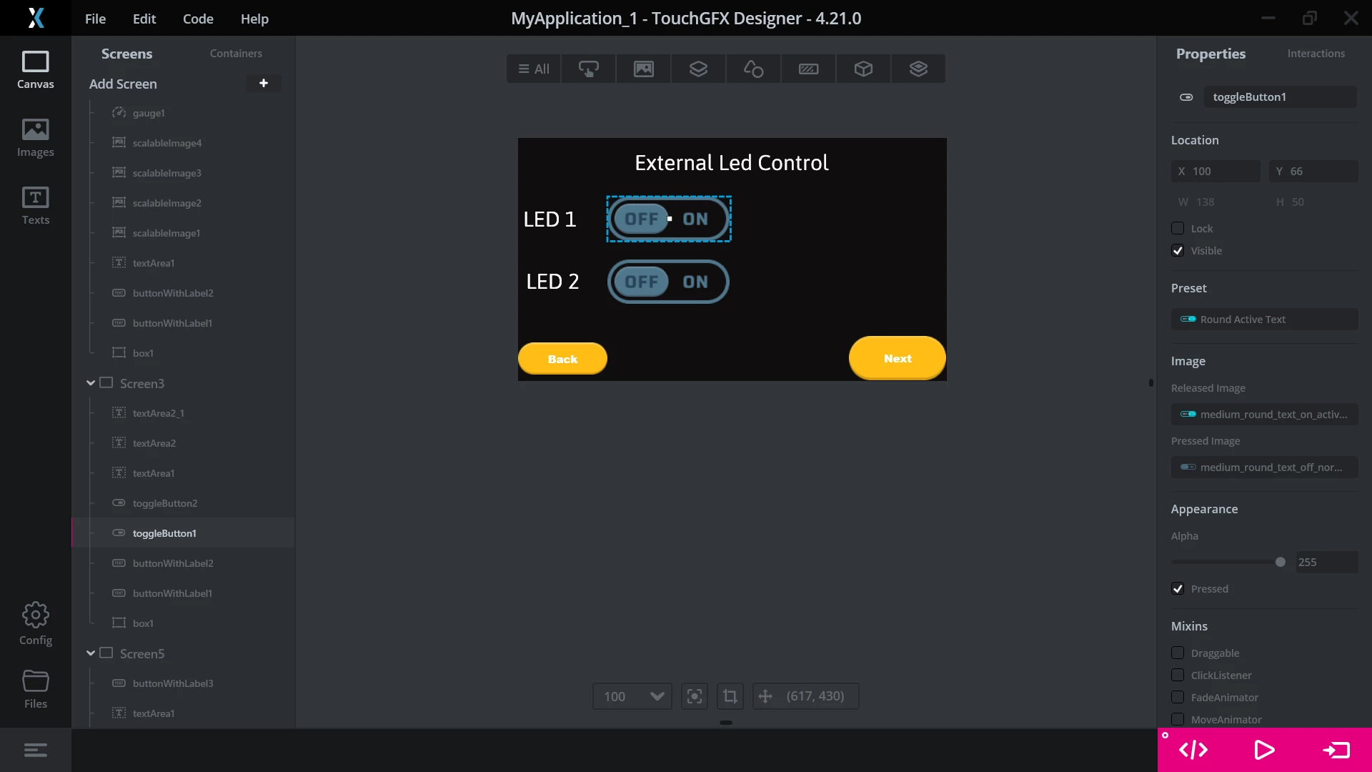

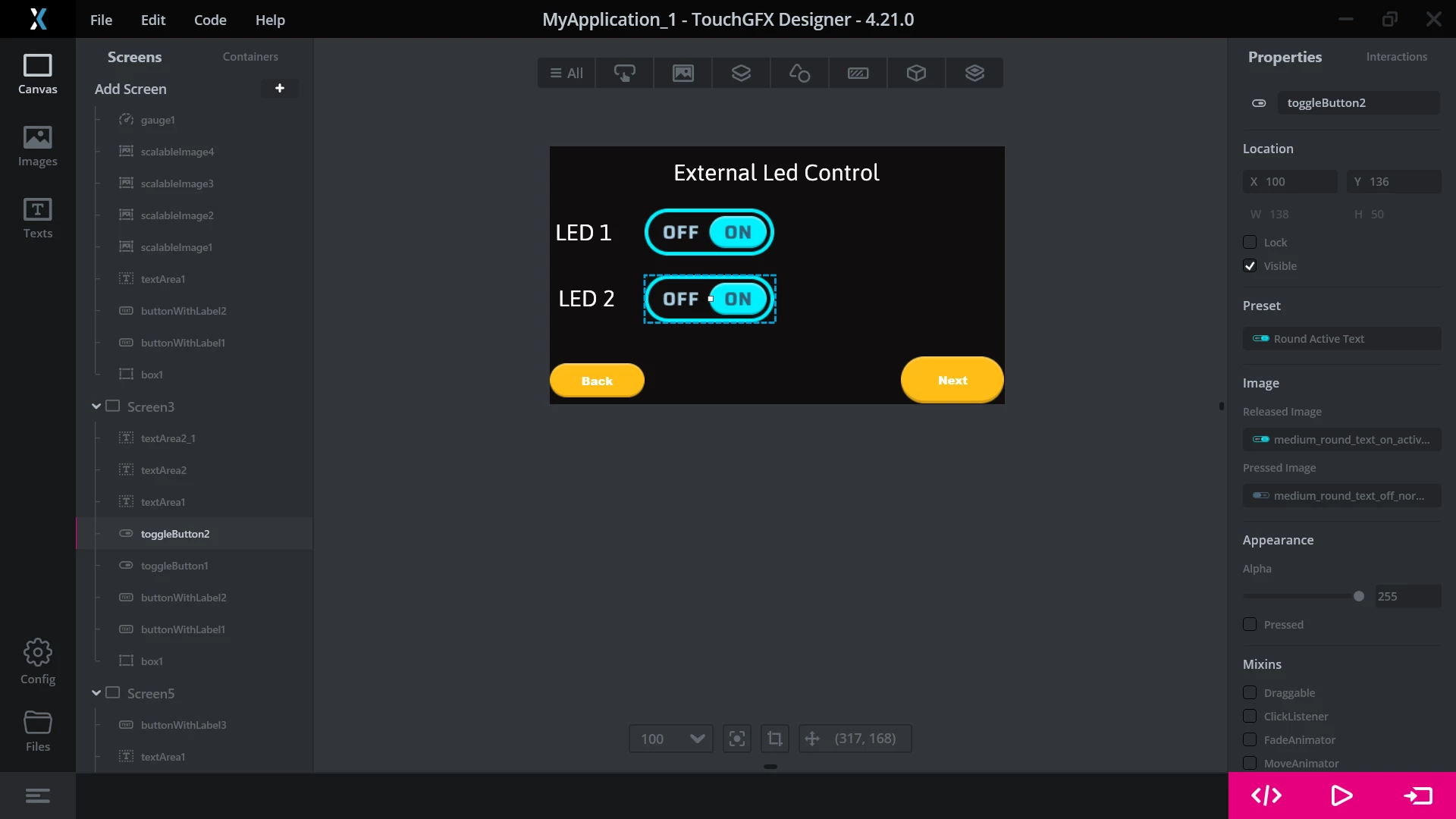

toggle button positon set at inialt level when we change the screen.
0693W00000Y83I5QAJ.pngif i will change this codition to "off" state during program excuation it will change to "off" .but when i change screen to another screen the position is came to starting point "on".

Hello @Ranjeet Singh​,
You will have to save the state of your toggle buttons (with a boolean variable for example) in the Model, and then read this value every time you switch back on your Screen (in the setupScreen() method inside ScreenView.cpp).
To do that, you can take a look at this article of our documentation, and also this one for a simple tutorial.
Moreover, you can try out the project I shared in this post.
It can help you understand how to save value in the model from the View and propagate values the other way.
/Yoann
