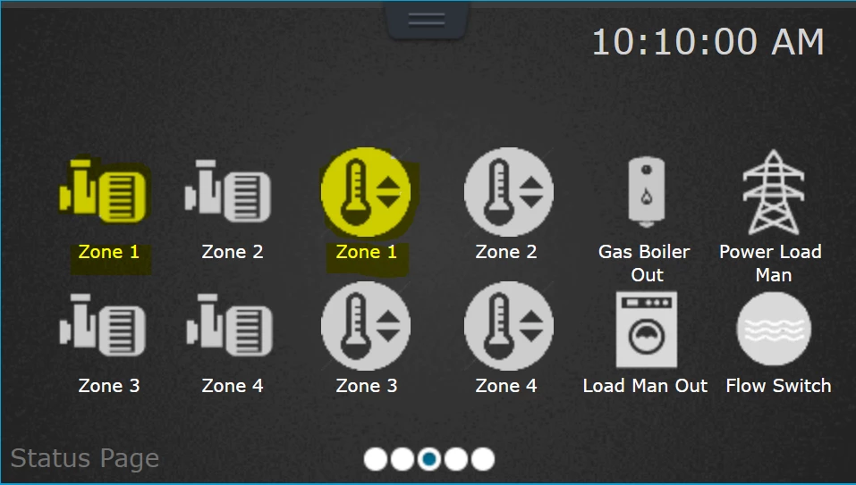

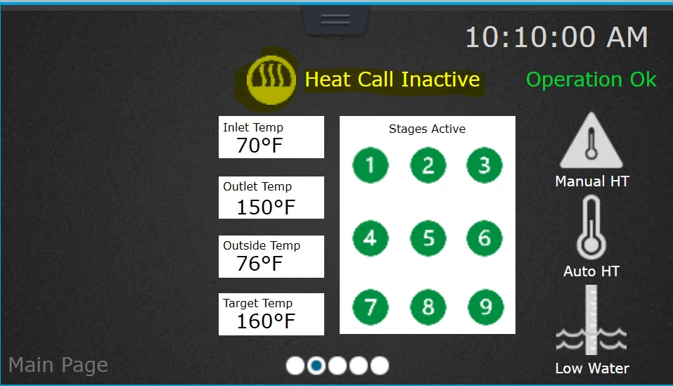

I'm using an event to update indication statuses in my screen. There are four independent events that update the screen in the same fashion (with different images toggling for active/inactive). I added in another indication to show that when any of the events are registered it would indicate the 'global' status as well as the individual statuses.
The individual statuses all indicate properly, and debugging shows the program is reaching every one successfully. However, in my global status, only the fourth event (zone4heatcallstatus) indicates the global indication.
The code is identical (except numbers) for all. Any idea why this could be happening?

Hi Alexandre,
See the following images. I have external interrupts which cause each of the zones to illuminate with respect to which interrupt was activated. Both of the screenshots are part of the same screen, just within a swipe container. For each interrupt the respective zones (1-4) properly illuminate in the first image. What is also supposed to happen in the second image on any of the interrupts driven is that the 'global' heat call active/inactive is supposed to illuminate as well.
What I can't figure out is why it only does it for zone 4 in the following code. I've debugged and each of the setZone4HeatCallStatus(uint8_t status) breakpoints are reached (as also evidenced by the state changes of the toggle buttons/images in the first image.

I am experiencing this issue in both my board and the simulator.
