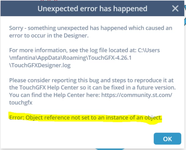

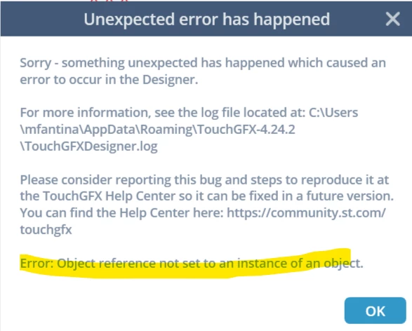

Today Touchgfx Designer 2.24.2 tell me "Error: Object reference not set to an instance of an object.", don't know!
Hello I’m developing long project.
Tomorrow I open the project and try to save it without any modification,
but appears this window
Can someone please help me, thankyou in advance.

Do you have a custom trigger on your codebase? It seems TouchGFX is unable to serialize it because it refenrence a Null
System.NullReferenceException: Object reference not set to an instance of an object.
at TouchGFXDomainModel.LoadSave.Serial.ToSerial.Convert(TriggerCustom t)
Most likely, one of your custom triggers is missing a required property (e.g., an action, condition, or a referenced screen/widget that no longer exists).

MauFanGilaMedical
Jul 14, 2026 7:39 AM UTC
I have just installed TouchGFX-4.26.1 but it has the same problem

thankyou … I individuate the TriggerCustom
MauFanGilaMedical
Jul 14, 2026 8:02 AM UTC
I belive the piece of the log that describes me the problem is
I removed interaction based on a CustomControl that I removed
  "InteractionName": "OnAesKeyCompleted",
  "Trigger": {
  "Type": "TriggerCustom",
  "TriggerCustomTypeName": "AesKeyGunGetter OnAesKeyCompleted happens",
  "TriggerComponent": "aesKeyGunGetter"
  "Action": {
  "Type": "ActionCustom",
  "FunctionName": "OnAesKeyCompleted"
and now it works
