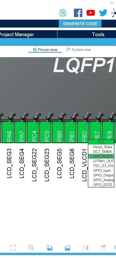

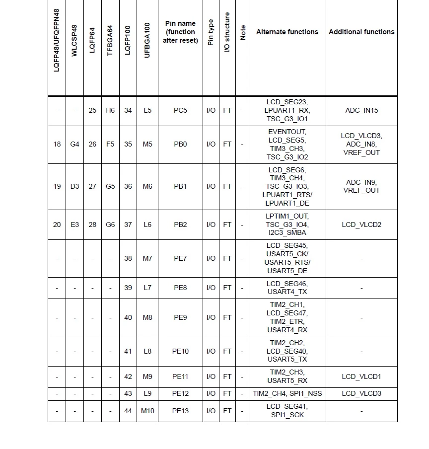

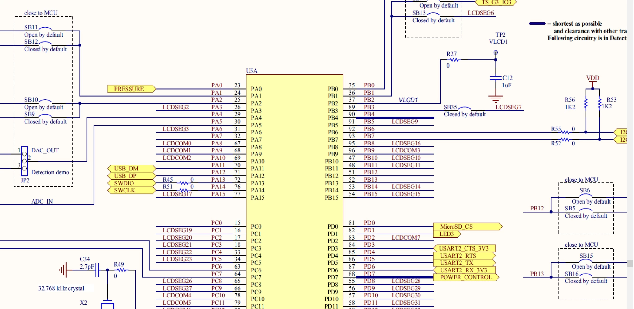

The Additional Function of PB2 is LCD_VLCD2 in the data sheet, but the same pin is set to VLCD1 in dm00171429-evaluation-board-with-stm32l073vz and CubeMX.
Which is correct?
I will attach the corresponding image
Best answer by Imen GH
The datasheet is correct.
Regarding the reference manual, table "VLCD rail connections to GPIO pins" is wrong.
The error will be corrected in the next release.

Hello @リョウスケ クボ​,
The correct one is LCD_VLCD2.
For documentation, I have reported the error to our team for correction.
For CubeMx,@Khouloud ZEMMELI​ Could you  please fix this typo.
Thanks for your contribution.
Imen
