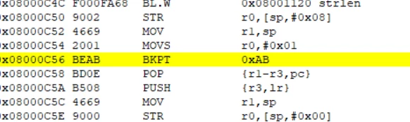

There is a bug in TouchGFX 24.1 with arm compiler 6.22.
BKPT will be inserted with arm compiler 6.22 .
The program does not automatically run down.
