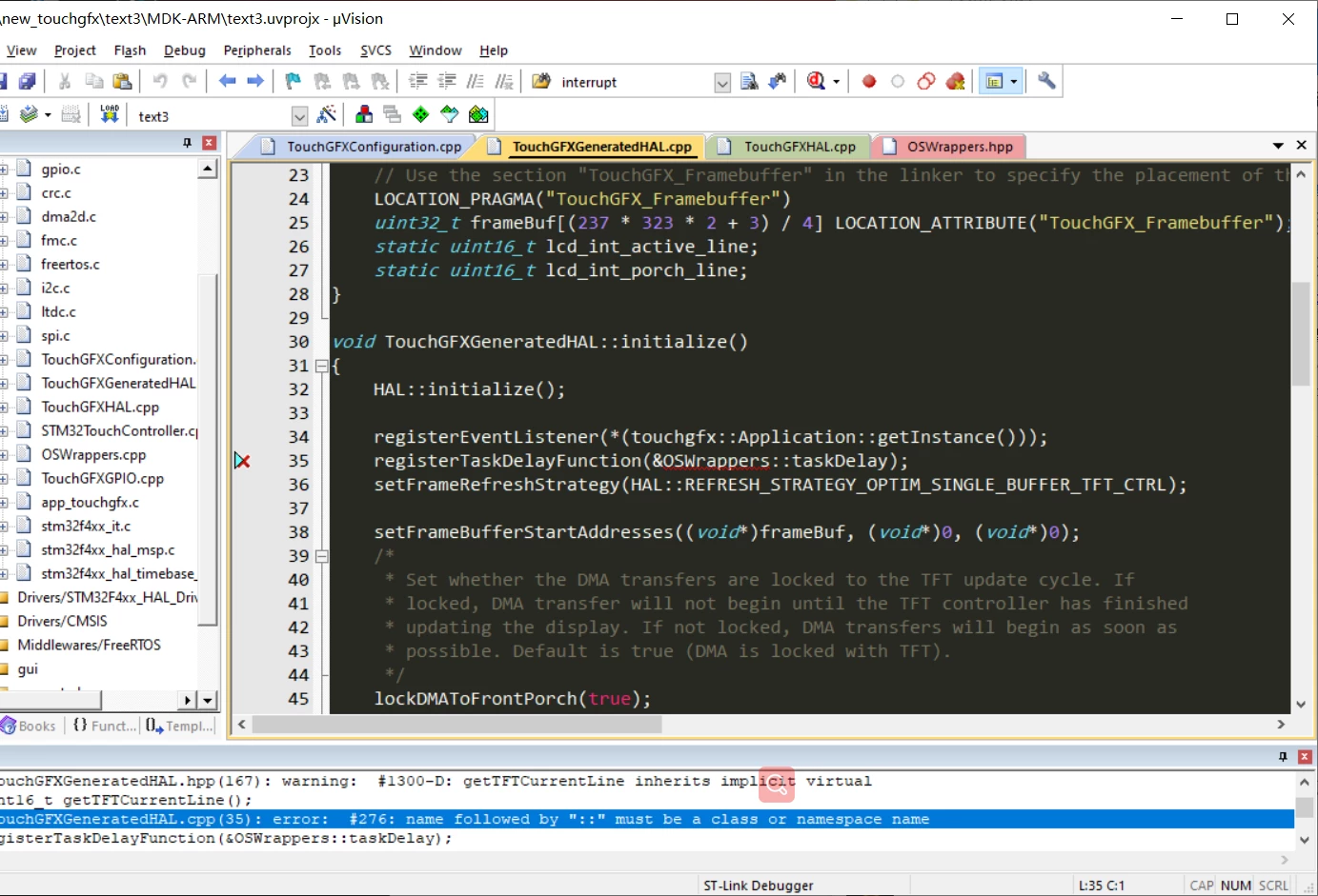

the touchgfx Generated code compile error
0690X00000Bxf7KQAR.pngcubemx v5.5 touchgfx v4.13.0 .
I've already canceled microLIB and c99.
it says no define .But I can go to its definition.
What can I do to deal the problem.

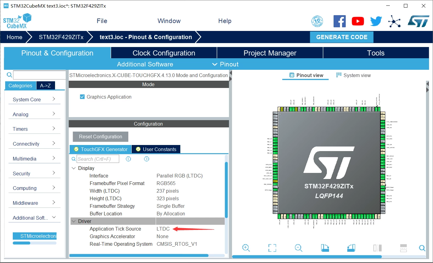

Oh, one little detail wrong.
  • The Application Tick Source should be chosen as LTDC .If we are unlucky enough to choose custom,We have to write a function ourselves
