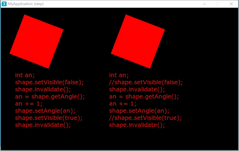

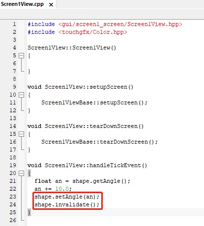

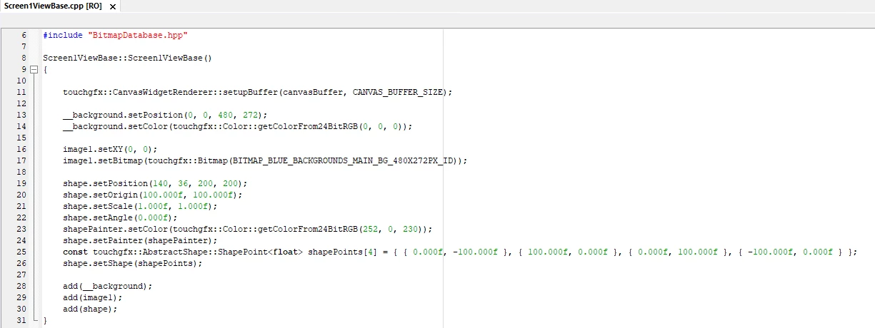

The shape widget setAngle
When the shape widget is set to a new angle, it can not completely remove the disability from the previous angle. Is there a Bug or is there another way to solve this problem? Thank you!0693W000006EkexQAC.png0693W000006EkesQAC.png0693W000006EkenQAC.png

Maybe workaround but try set visible false ... invalidate ... setAngle ... visible true ... invalidate

0693W000006Em6nQAC.pngExactly�?​thanks, :thumbs_up:
As if the setVisible function could be omitted?
MM..1
December 7, 2020
when invalidate do job then yes you can omit
