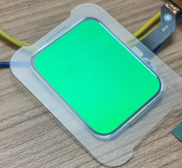

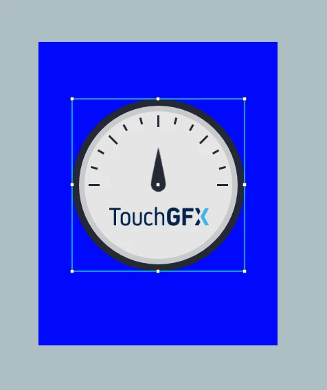

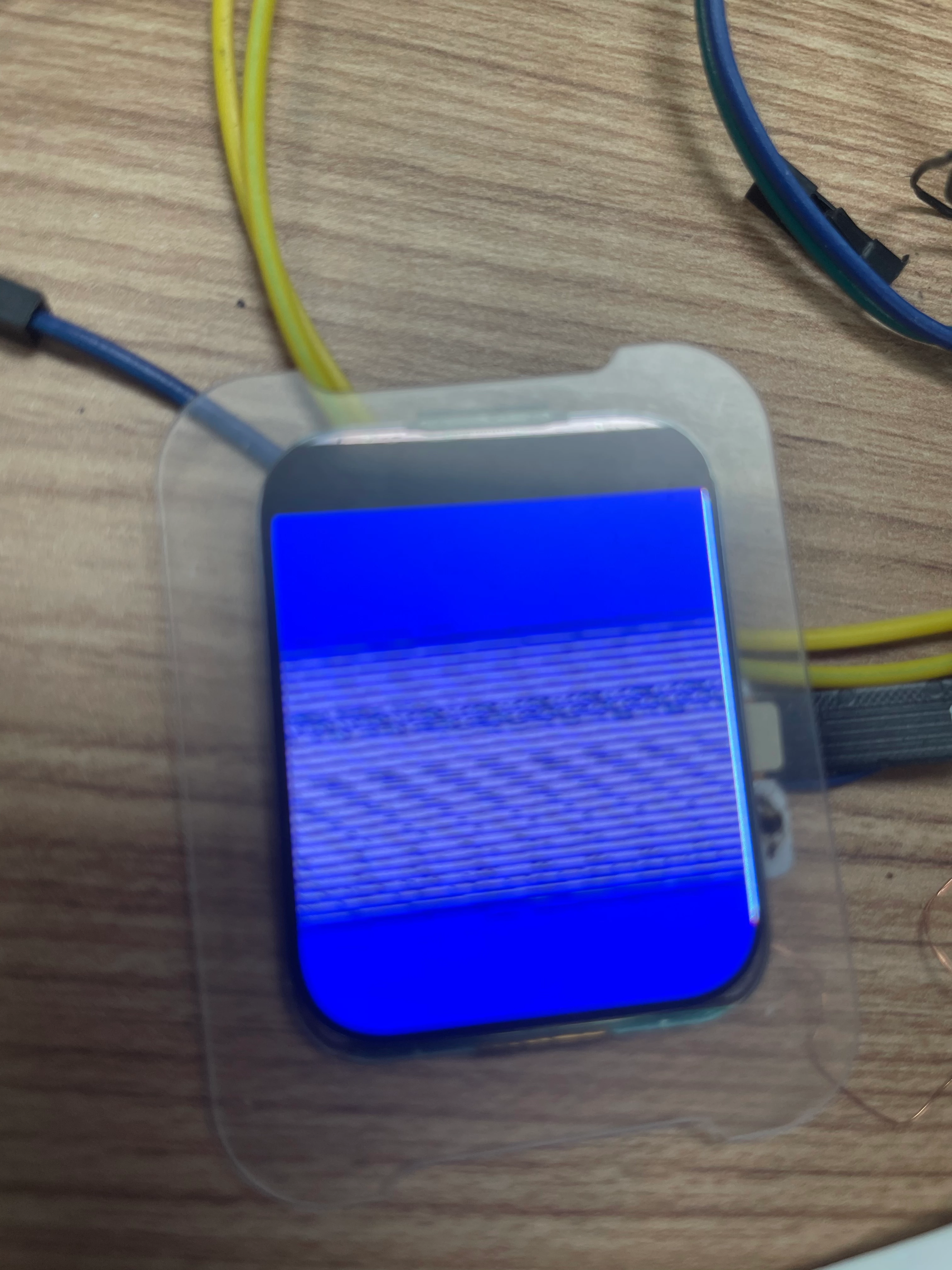

(1) The GUI displays an exception. The problem can not be determined. It is suspected that the data sent by dma2d is incorrect. At present, there is no touchgfx fill interface function???
(2) Close the GUI display function, directly call the bottom dma2d write screen cleaning function, can display normal!!!
The screen uses DSI Mipi
GUI display content:0693W00000ANrUyQAL.png
Screen display after opening GUI:0693W00000ANrTCQA1.jpg
Close the GUI and use the clear screen function:0693W00000ANrW1QAL.png
Best answer by Zlian.1
I modified Hal_ DSI_ Longwrite about DSI_SET_COLUMN_ADDRESS parameter
