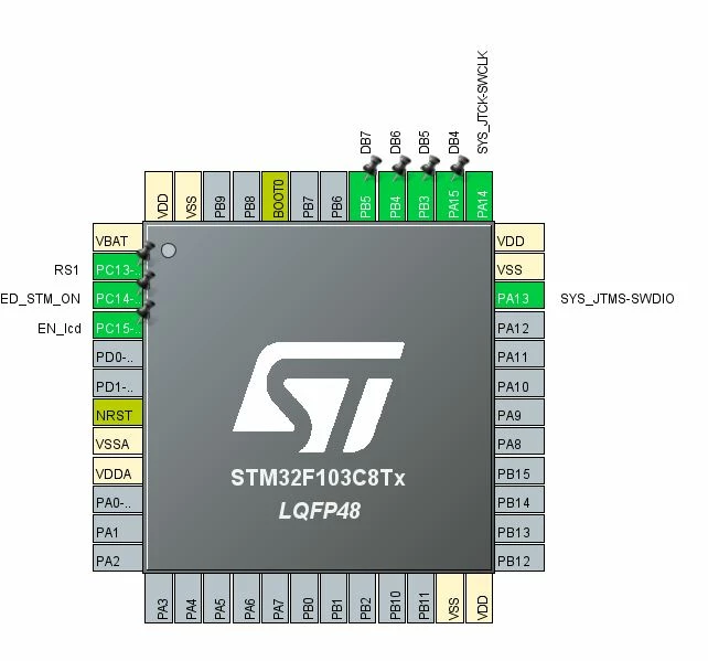

The LCD is working but not showing any character?
I am using stm32f103 and IAR for codes.
I am trying to use a character LCD 16x2 for my project. It turns on with 5 volt that I connect but not showing any character. I changed the potentiometer and still no sign of characters.
I was wondering what the problem is?

I attached the library that I used and a picture of CubeMX.
I would appreciate any help.
Ali/

LCD have RW pin too , how you manage it?.
ATavo.1
ATavo.1Author
May 7, 2022 11:09 AM UTC
always 0. in board with ground.

If you are using well "proved" library wrong pinout is the most common mistake. Your library looks "unproven", then there can be multiple errors. First question is communication timing. Does your library comply all timing requirements for ENABLE pin pulse, hold a setup times on all signals ? From breif view at your code it look like no. Another common mistake is initialisation sequence (and its timing). Find some proven library or thoroughly read HD447800 datasheet, especially initialisation.
