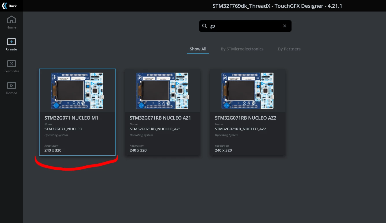

The documentation about lcd configuration in the project of G0+TouchGFX without using X-NUCLEO-GFX01Mx. THANKS !

Is it necessary to use the X-CUBE-DISPLAY package in CubeMX anyway?
3 replies
Romain DIELEMAN
February 2, 2023
It is not necessary to use the X-Cube-Display package. The TouchGFX Board Setup for the STM32G0 nucleo M1 available in TouchGFX Designer does not use it. You can have a look at it to understand the implementation. Concerning the documentation, have a look at the board bring up articles in the online documentation (available in Chinese as well). This other article will further help you configure spi displays on the G0 (if this is what you are going for).

Thank you Mr. Romain DIELEMAN for your quickly answer to me.
Bonjour Monsieur,I'll do something according to your guide as soon as possible.
JMYGI
February 2, 2023
@志肖.1 please share more details about your display project and needs - and we can support you well
