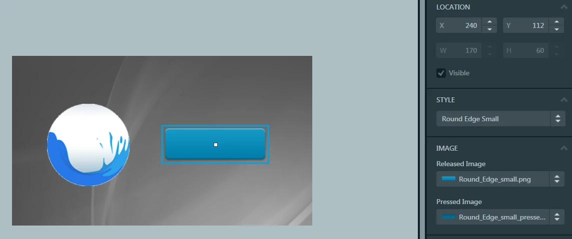

bool STM32F7TouchController::sampleTouch(int32_t& x, int32_t& y) is working as it can be tested by setting a breakpoint. The display is running as it is tested with an animated image that runs fine.
It runs fine in simulator but not on stm32f746G-discovery (Working with STM32CubeIDE 1.1.0) : The display is not reacting on button pressed at all.
Any hints to get the touch working with the display are welcome.

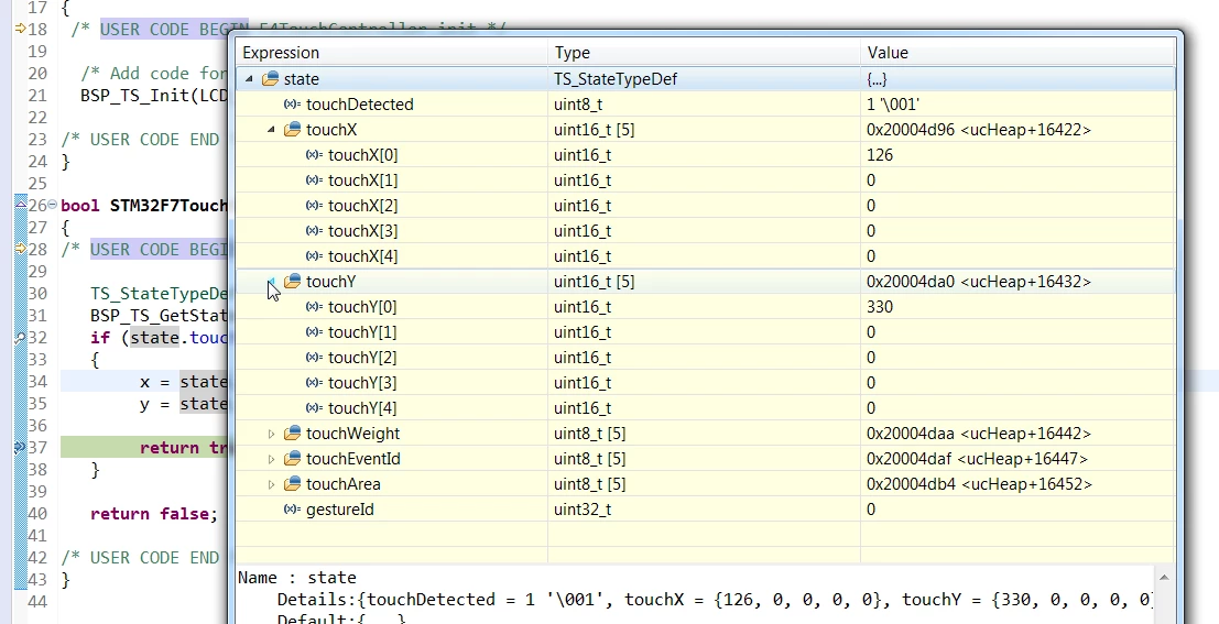

So you've tried breaking inside the touch controller and inspecting that the actual coordinates that you're pressing are what's being read back?

The coordinates seems to be plausible (126, 300).0690X00000ArjmzQAB.png0690X00000ArjmuQAB.png
