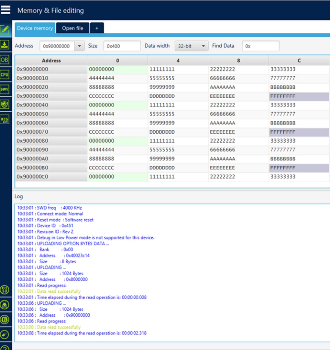

I follow the guide to make an external loader and it works for the most part. I can erase sectors, write data. But I can only read data once. If I try make multiple Read, STM32CubeProgrammer returns error. See example below:
Example:
14:56:32 : Time elapsed during the read operation is: 00:00:00.007
14:56:35 : UPLOADING ...
14:56:35 : Size        : 1024 Bytes
14:56:35 : Address     : 0x90000000
14:56:35 : Read progress:
14:56:37 : Data read successfully
14:56:37 : Time elapsed during the read operation is: 00:00:02.314

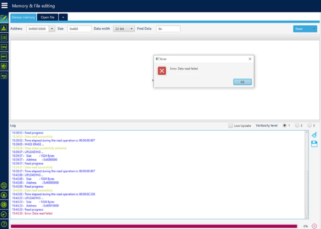

15:18:18 : UPLOADING ...
15:18:18 : Size        : 1024 Bytes
15:18:18 : Address     : 0x90010000
15:18:18 : Read progress:
15:18:26 : Error: Data read failed
It does not matter, which start address I use in the second read request. If I use Address: 0x90000000, in the second read I receive same error.

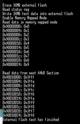

The code in the main() is then executed. I am then able to enable memory mapped mode and make several read from different segments in the external flash.
Example:
Erase 16MB external flash
Write 16MB test data into external flash
Enable Memory Mapped Mode
Read data in memory mapped mode
0x90000000: 0x0
0x90000004: 0x1
0x90000008: 0x2
0x9000000c: 0x3
Read data from next 64kB Section
0x90010000: 0x3fff
0x90010004: 0x3ffe
0x90010008: 0x3ffd
0x9001000c: 0x3ffc

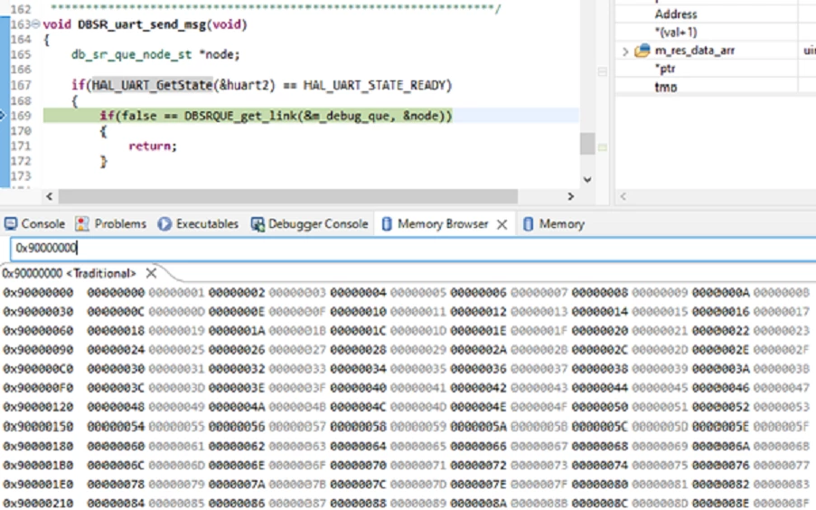

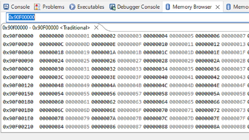

When I execute code in "non-extern-loader-mode"
I am then able to use ST-Link and STM32CubeIde memory browser and view several memory sectors without any problem, so the driver seems to work as it should.
The file: Loader_Src.c
In the end of the function Init(), I invoke BSP_QSPI_EnableMemoryMappedMode(). This function is also invoked in the beginning of the function Verify().
