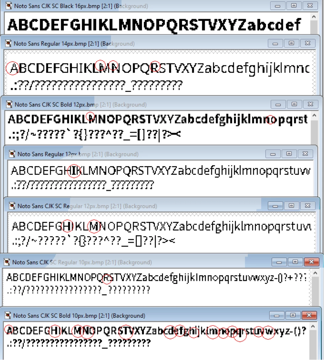

moredatalesscenter
July 22, 2021
0693W00000D0KDgQAN.pngIs there a solution to make characters on a 1 bpp screen less blocky (see annotated screenshot)?
