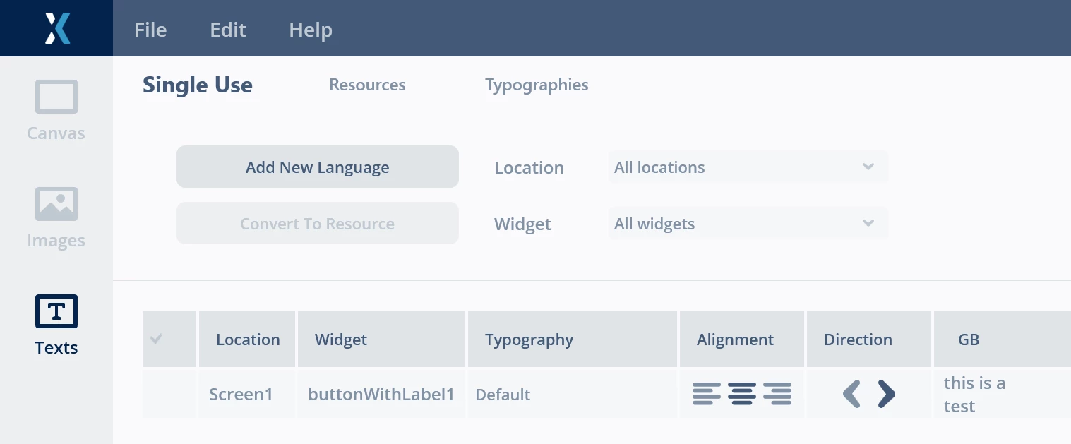

TGFX 4.18.1 button with label, two lines of text issue
To reporduce
new project> add widget> button with label> text box text "this is a" hit enter key "test", should make a button with two lines of text. Was working on TGFX 4.16.1. Has the method changed?

Hello @markH​ ,
In TouchGFXDesigner 4.18.1, if you want to display 2 lines of text on your FlexButton, you can simply go to the Texts tab, then add manually the new line for the resource you want :
Hope that this helped,
/Yoann

Hello @markH​ ,
/Yoann

Yes thank you that works!
