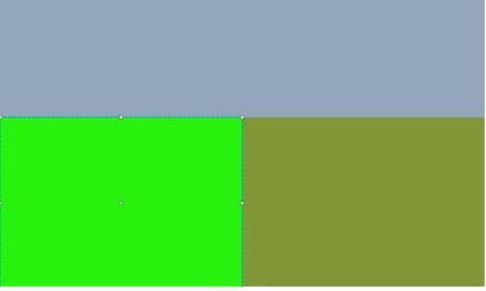

I run application using TouchGfx desiginer like following on our board. the image displayed is broken.

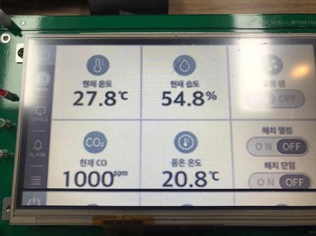

1) here's what I expected.

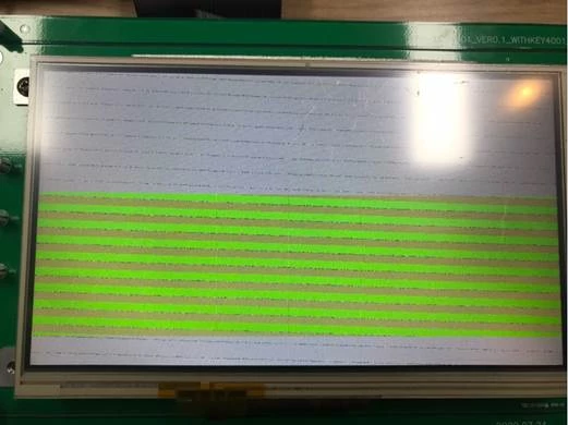

2)here's what is displayed

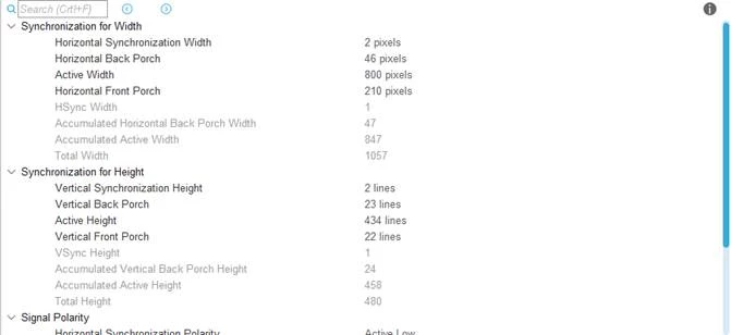

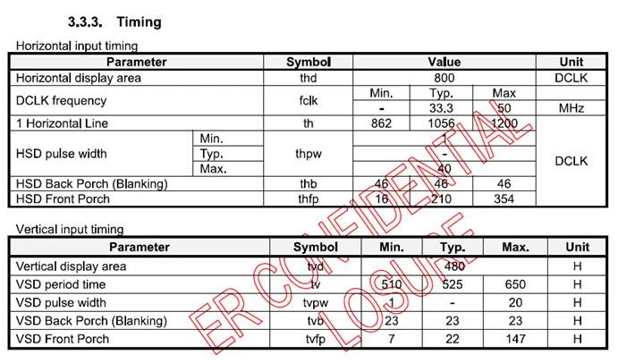

Here's the tft lcd display setting we're currently using.
And I set LTDC setting on CubeIDE for this setting like following.
When I play png image(using by lcd-image-converter) directly on frame buffer, the image is displayed correctly except "color is black & white"
Could you please check which setting/or compiler option? / library should I chage to fix this?

Hello, my answer is probably too late, but check (in your .ioc file) the clock configuration: you probably see a "to LTDC (Mhz)", it must be set on the right value (in your case 33.3-50 Mhz, I presume).
