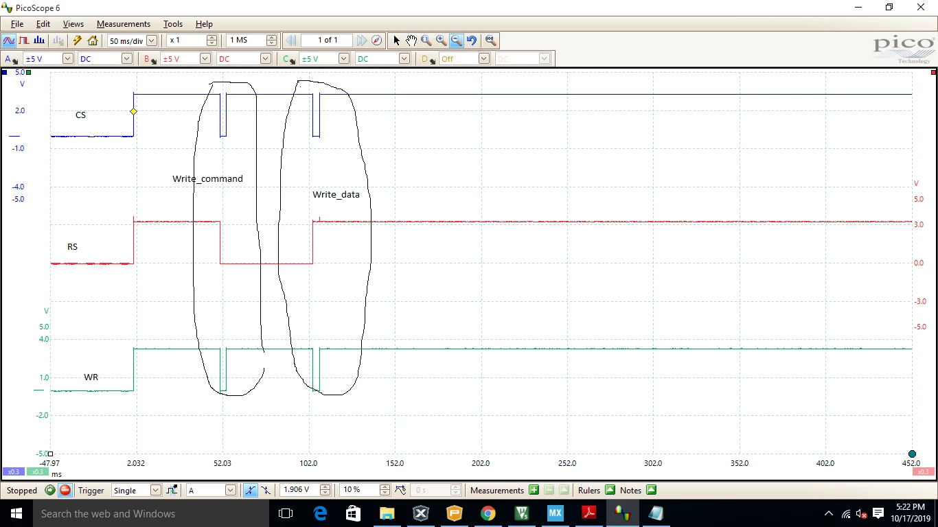

ykn
yknAuthor
Oct 17, 2019 11:59 AM UTC
Initially All controll pin high for 50ms then Write_Command(); delay 50ms Write_data();
please see the attachement.
T J
Senior III
Oct 17, 2019 12:56 PM UTC
which trace is which ?
where is the nCS pin ? RST pin ? RS pin?
you need to see all the pins...
are you sure the data pins are doing what you expect ?
You will see the issues on the scope...
I hope you have secure hook up wires and not lose connections, did you solder them in place ?
Check the power rail is correct too, did you add a capacitor on the display side of the power wires ?
a solid ground wire is necessary, a thicker wire is always a good starting point for ground.
good luck.

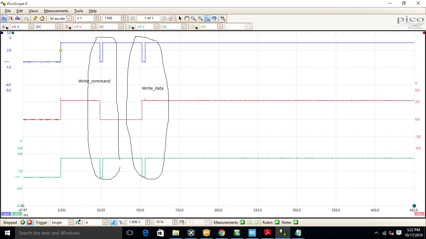

ykn
yknAuthor
Oct 18, 2019 8:32 AM UTC
i checked the level of data pin, and it is according to the data. i have reset the display at the starting of main function.
TFT proto 5" is adisplay module with SSD1963 inbult controller, it has D[0-15], cs, RD, WR,RST, TE, RS pin 3.3V and GND pin for external connection with the controller.0690X00000AqWg3QAF.png
T J
Senior III
Oct 18, 2019 8:45 AM UTC
those pins look good
You have to check the other pins and the startup code.
Is reset High active or low active ?
the backlight is separate from the LCD data usually,
so you should see some light somewhere,
otherwise shine a bright light on it, you have an image but no backlight.
good luck, you need to do your own discovery, if it was easy everyone would be doing it.
check your ground wire is thick, and your power is clean..
good luck.. keep working on it...
