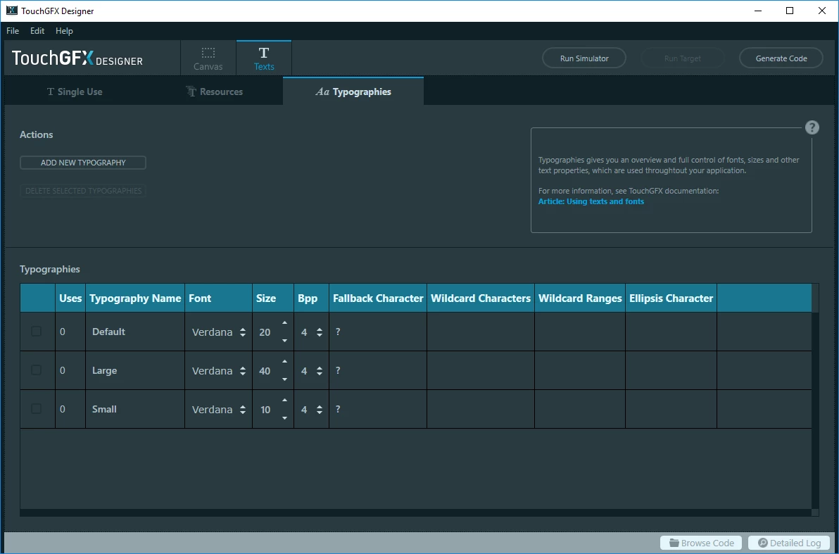

Hi Antoine,
I seems that you have pasted the same code snippet twice.
When TouchGFX displays a "?" instead of the desired character it is usually because the glyph for that unicode is not within the wildcard characters/ranges.
You can add these characters in the Designer under Texts -> Topographies
Regards

AMege
AMegeAuthor
Jul 16, 2019 3:44 PM UTC
Hi Martin,
"I seems that you have pasted the same code snippet twice."
No, I did not, notice the capital W?
Thanks for your answer, I have now a better understanding how TouchGFX works with text and fonts and I have resolved the issue.

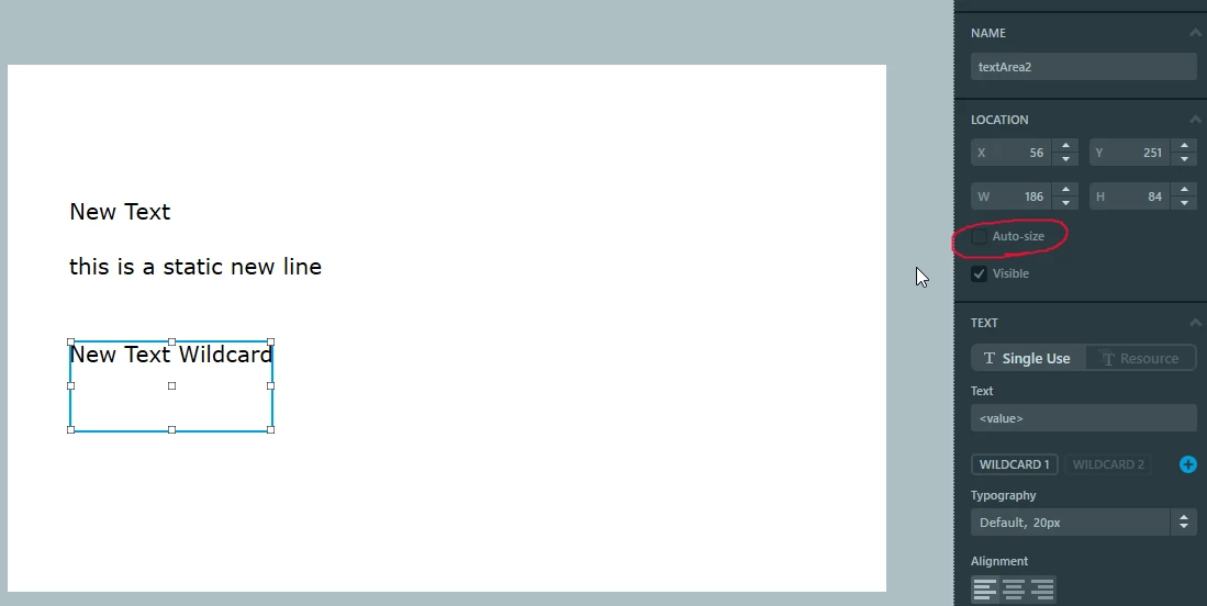

The text area where you have a wildcard which contains newlines, you need to remove the check "Auto-size" in the Designer and then expand the size of the text area.
Adding new lines are done as usual with \n
	Unicode::fromUTF8((const uint8_t*) "Hello World!!\nNew line", textArea2Buffer, TEXTAREA2_SIZE);
	textArea2.invalidate();
Running the application will yields "New line" written on a new line for a wildcard text (BTW, pressing F3 creates a screenshot of the simulator)

AMege
AMegeAuthor
Jul 18, 2019 3:52 PM UTC
Removing Auto-size seemed a bit counter intuitive, but yes, that worked. Thanks!
Anders Nedergaard PETERSEN
Senior II
Jul 19, 2019 6:38 AM UTC
That's because the "auto-size" calculation is done before the code is generated -> The Designer calculates the size of the text input and then sets up the high and width of the text widget.
The wildcard rendering is done at run time, and thus the needed size of the text widget is unknown.
