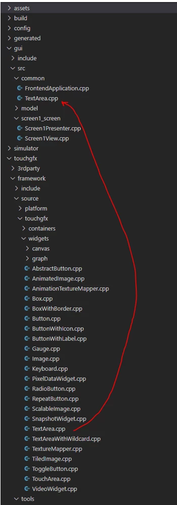

If you still want to use 4.20.0, you can still fix the bug manually :
  • Navigate to touchgfx/framework/source/widgets/TextArea.cpp file.
  • Copy-paste this file to your gui/src/ folder, for example in gui/src/common/.
  • Open the file and replace line 277 :
Replace
while (wtis.getCurrChar() != 0 && widgetRectHeight > lineHeight);
With
while (wtis.getCurrChar() != 0 && widgetRectHeight >= lineHeight);
  • Generate code
  • The bug should be fixed.
