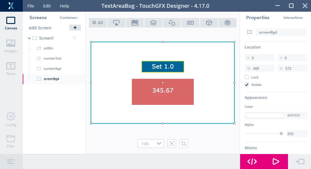

Simple Screen
The project includes a single screen with a white background, and three additional objects:
  • A blue Flex Button (setBtn), labeled “Set 1.0�?
  • A single-wildcard TextArea (numberText( with initial setting “345.67�?
  • A red Box background (numberBgd) to the TextArea.
Screen Appearance

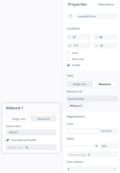

0693W00000UnfacQAB.pngTextArea
The TextArea (numberText) is of fixed width, non-autosize, includes a buffer with a 16 character size. and has an initial setting og 345.67:
0693W00000UnfawQAB.pngText Resource
The text resource (numberDisp) specifies the default font, centered display, and single wildcard (<>):

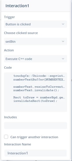

The screen defines an interaction for a click on the setBtn to execute inline C++ code:
0693W00000UnfbQQAR.pngScenario 1: Text Replacement Error
In the first attempt, the following code places the number “1.00�? into the text buffer associated with TextArea numberText:
 touchgfx::Unicode::snprintfFloat(numberTextBuffer, NUMBERTEXT_SIZE, "%.2f", 1.0f);
 numberTextBuffer[NUMBERTEXT_SIZE-1] = 0; // ensure string termination
 numberText.resizeToCurrentTextWithAlignment();
 numberText.invalidate();
One would expect that numberText would now display “1.0�? against its red background. But, instead, the following screen is displayed:

"Invalidating" is the action to rewrite on the framebuffer and so, in your screen. The issue you're facing is not a bug. Indeed, as described in our documentation you need to invalidate the entire area that needs to be redrawn. So in your example, when you're calling resizeToCurrentTextWithAlignment() function you're actually reducing your text area size. So in the framebuffer the allocated space for this area is also reduced. Then when you call invalidate() you'll just rewrite inside this reduced sized area in your framebuffer. That means that the other numbers at the edges of your text area will still be visible, because in the framebuffer, they've not been updated.
What you'll need to do instead, is to call invalidate() before resizeToCurrentTextWithAlignment() so the numbers at the edges will be also included in this area to be "refreshed", and after you can call resizeToCurrentTextWithAlignment() to reduce your text area size.
This is also why in your scenario 2 and 4 it's working fine, because you're asking to redraw your entire rectangle area in the framebuffer, that includes the numbers of the edge of your reduced sized text area.

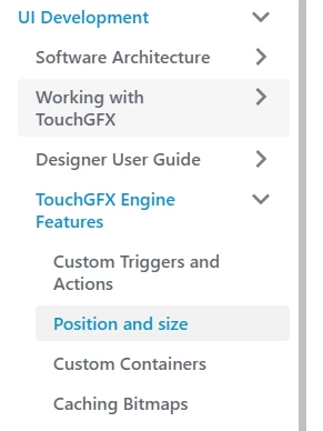

It would be great if every programmer learning a new environment first made a detailed study of the existing documentation (which, in the case of TGFX I note has been given a lot of effort), and then proceeded with all of it imprinted in memory for ready recall when coding. However, even if this were possible, documentation, like code itself, must be continuously revised if it is to remain useful and effective.
So, when I first read your reply, as one who tries always to proceed only after a survey of documentation and the development environment, I was a bit embarrassed by my oversight. And, in retrospect, the problem seems obvious.
As it turns out, in my post, I failed to include the fact that we're operating in version 4.17 of TGFX---the version is fixed by my client's policy during phase 1 of the development effort. And, in fact, the documentation reference you provide, which clearly explains the issue here, was not present in 4.17 documentation, at lease not in the place it occupies in the 4.20 document ("Position and Size"), and not anywhere that I could locate by searching in 4.17:
4.20 Documentation
4.17 Documentation
So, finally, all's well that ends well. And, when my current client or a future client selects 4.20 (or whatever then is the current version), I promise once again to go over the docs to make sure I'm aware of all the new information and nuance that has been added.
