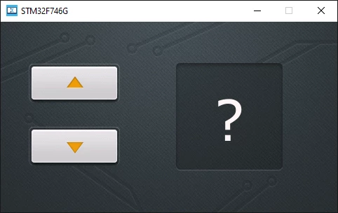

TextArea widget display failure
Using TOUCHGFX Rev 4.24.2
And following https://support.touchgfx.com/academy/tutorials/tutorial-02
TextArea widget fail to show valid value.
void MainView::buttonUpClicked()
    touchgfx_printf("buttonUpClicked\n");
    counter++;
    Unicode::snprintf(textCounterBuffer, TEXTCOUNTER_SIZE, "%d", counter);
    // Invalidate text area, which will result in it being redrawn in next tick.
    textCounter.invalidate();
What am I missing?

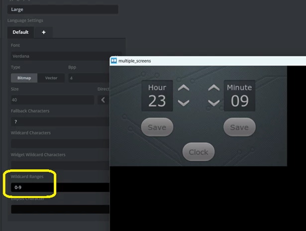

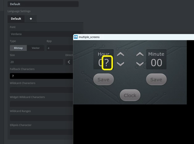

    Problem:
    Display ? in Text Area
    Solution:
    Add wildcard Range 0-9 in <Texts><Typograpies>
