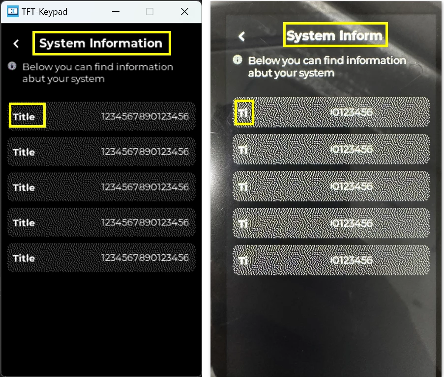

I have develop the UI for screen use RGB222, it's worked well on simulator. The external flash on device is QSPI and it's worked too.
I have some dynamic text like language change, update textarea by special TypedText Id.
The "System Information" is dynamic text and  the text will be align to center after set new TypedText. It's probem to show on real device.

Hello @SNguy.3,
Have you try to untick the auto size on your text area and resize your text area to fit the biggest possible value ?
