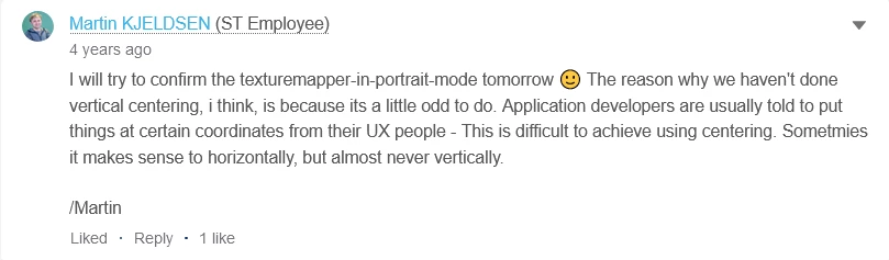

Hi @Osman SOYKURT​ ,
"we could consider to add it in a future release if it's a big help for users"
Please do, thank you. Big help. I think it is a common feature (Qt::QLabel, emWin::GUI_SetTextAlign).
However, I found this very interesting comment from Martin KJELDSEN on why it was not implemented:
