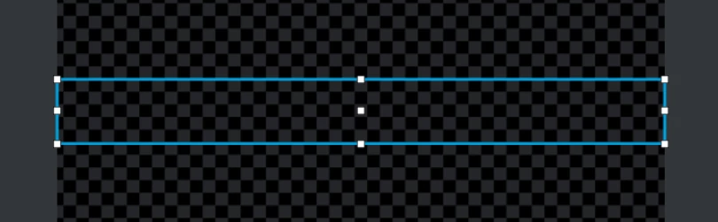

I have a TextArea that spans the full width of my screen:
I've selected "center" alignment:

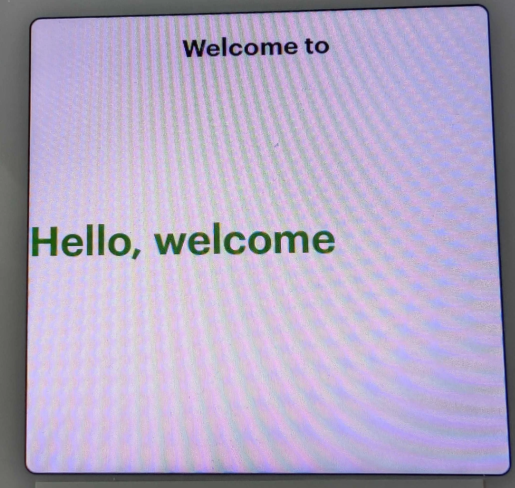

However, when I dynamically set the text at runtime,
 Unicode::fromUTF8(merchant_name_data, merchant_nameBuffer, MERCHANT_NAME_SIZE);
 merchant_name.resizeToCurrentText();
 merchant_name.invalidate();
It ends up left-justified:
? Thanks.
farble1670Best answer
Aug 5, 2024 9:04 PM UTC
My mistake, obviously I'm resizing the text area.
 merchant_name.resizeToCurrentText(); // Don't do that
