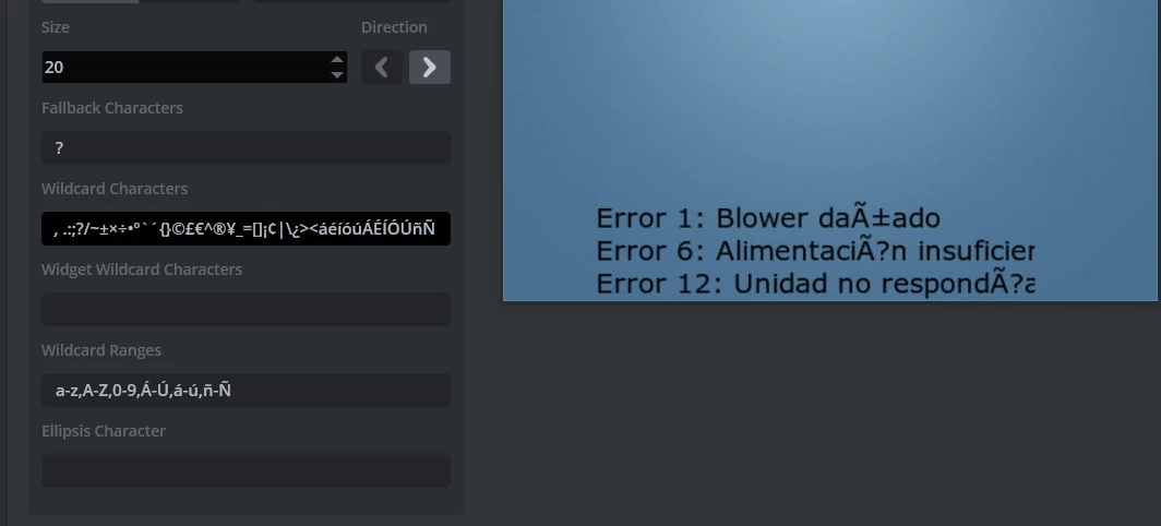

Hello to all ,
I am wanting to display a text that changes over time what it says, this works fine but for some reason the letters with tilde or the Ñ does not appear.
I put a picture of how I set the typography and how it is shown badly written in the simulation.
in “wildcard characters” I added áéíóúÁÉÍÓÚñÑ and in “wildcard ragne” I put ,Á-Ú,á-ú,ñ-Ñ but it did not work.
why does this problem occur?
Error 1: Blower dañado
Error 6: Alimentación insuficiente (it was cut off by the scrollablecontainer, it doesn't matter)
Error 12: Unidad no respondía
    ferro
    ferroBest answer

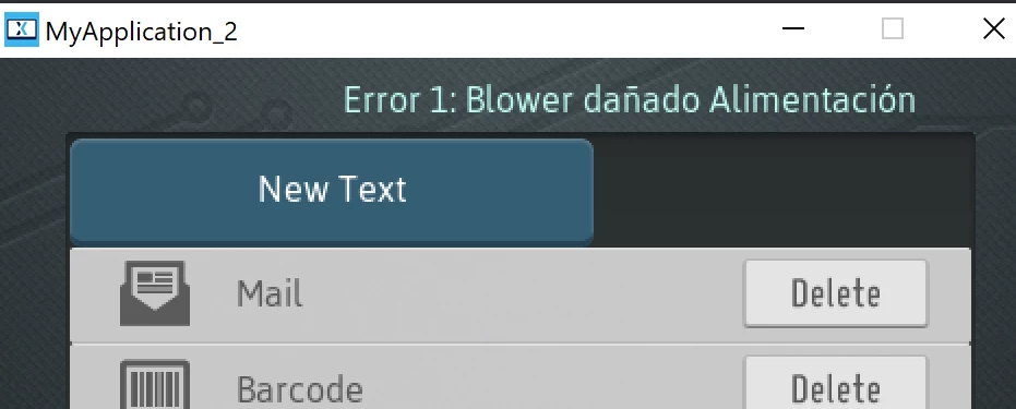

    Jan 3, 2025 9:37 PM UTC
    Hi @Maximiliano
    Prefix the string with 'u'
     Unicode::snprintf(texto_errorBuffer, TEXTO_ERROR_SIZE, "%s", u"Ñá");
     texto_error.invalidate()
    I attached example project.

    Jan 3, 2025 7:38 PM UTC
    Hello @MM..1  thank you for replying.
    the fault is in the buffered text.
    I also tried putting directly a ñ or a letter with tilde and it fails too.
    I don't know if I understood correctly, but is your capture of a text without buffer?
     Unicode::snprintf(texto_errorBuffer, TEXTO_ERROR_SIZE, "%s", "Ñá");
     texto_error.invalidate();

    MM..1
    Jan 3, 2025 8:28 PM UTC
    Strings in your source files is in UTF8 , then cant be used directly... why you dont read solution?
