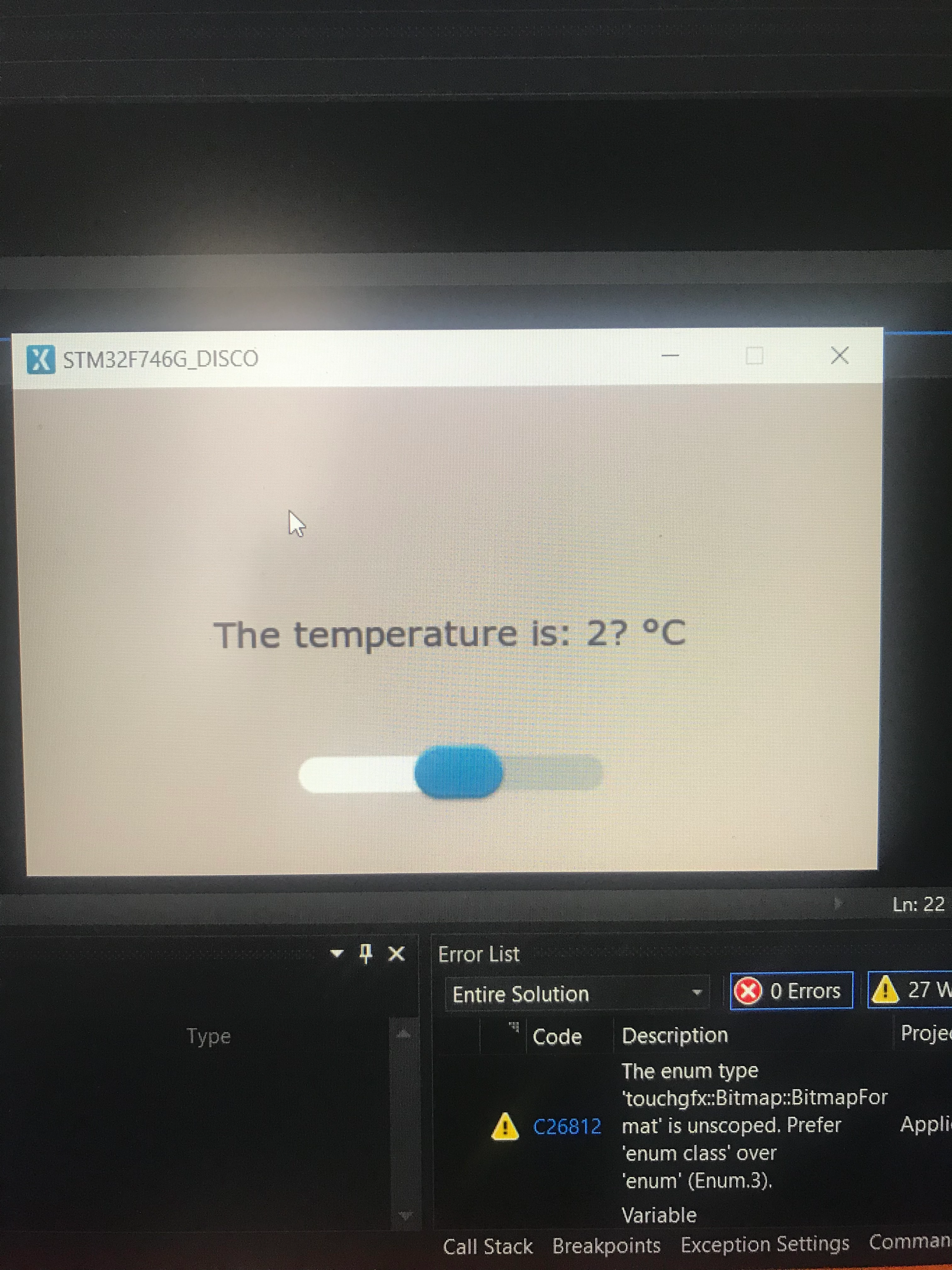

I made a simple project to test TouchGFX, when I move the slider I got error values, the initial value I’ve set in TouchGFX Designer is 25, so when I move the slider if the value contains 2 or 5 it will show with an other character
this is is my code:
void Screen1View::SliderChanged(int value)
unicode::snprintf(textArea1Buffer, TEXTAREA1_SIZE, “%d�?,value );
textArea1.setWildcard(textArea1Buffer);
textArea1.invalidate();

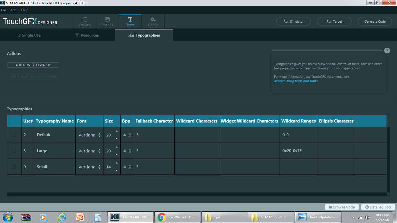

you should add all digits you want to use (0-9) to your project (Texts -> Typographies -> Wildcard ranges).

PBull
May 2, 2020 3:46 PM UTC
In your Designer (Texts -> Typographies -> Wildcard ranges)
Karan 123
Senior
May 2, 2020 4:52 PM UTC
Please Check below Image.

idrissmc
idrissmcAuthor
May 3, 2020 9:06 PM UTC
Thank you
