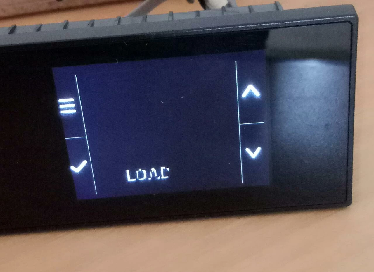

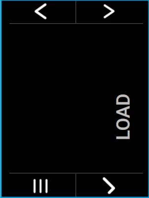

In touchgfx software....0693W000005ARaLQAW.pngIn Display Board......0693W000005ARgTQAW.jpg
Is there is any way so that I can fix it....?

Here is some suggestions you can look into :
  • Update to TouchGFX 4.15
  • Try with an ST board (STM32H750-DISCO) to see if you have the same problem
  • If you use external Flash and your fonts&Texts are in external Flash, try putting them in internal Flash.
  • If you use external Flash, check that your external Flash is correctly set.
Also, please give more information on your setup.
/Alexandre

Greetings,
My problem got solved by changing the MPU_Config() from main.cpp. Thanks for your Support.
Regards
Rishikesh G

When your question is answered, please close this topic by choosing Select as Best.
Could you share your new MPU_Config that fixed your issue ? This can help others as well.
/Alexandre
