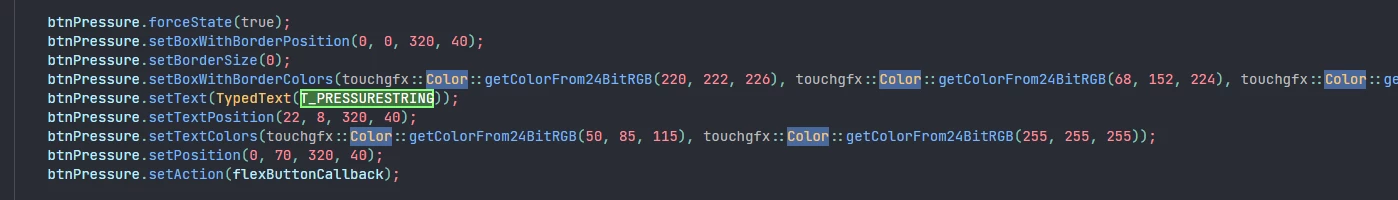

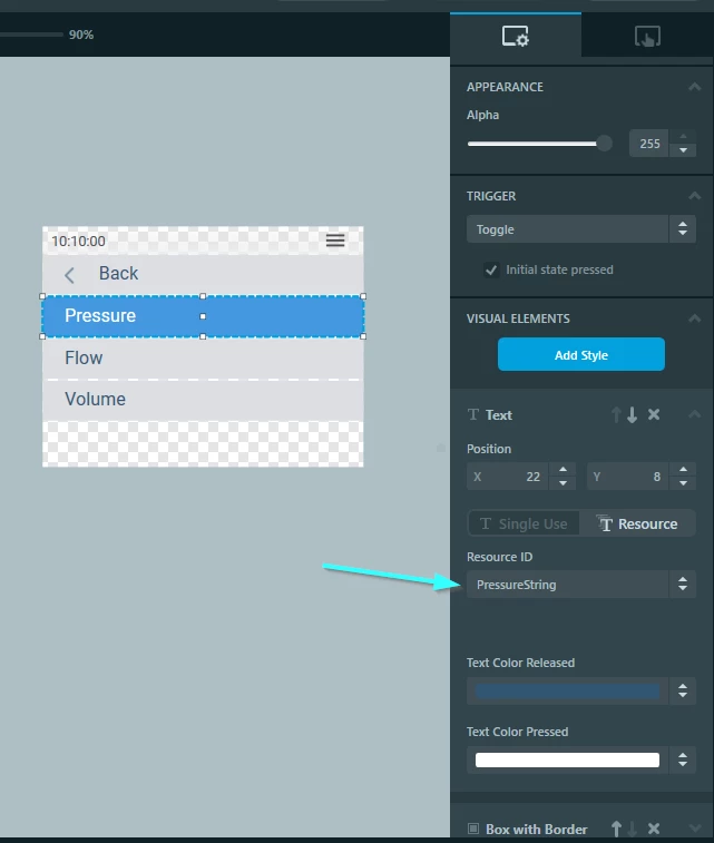

A: Yes. I think so. Here's an example of the PressureString:

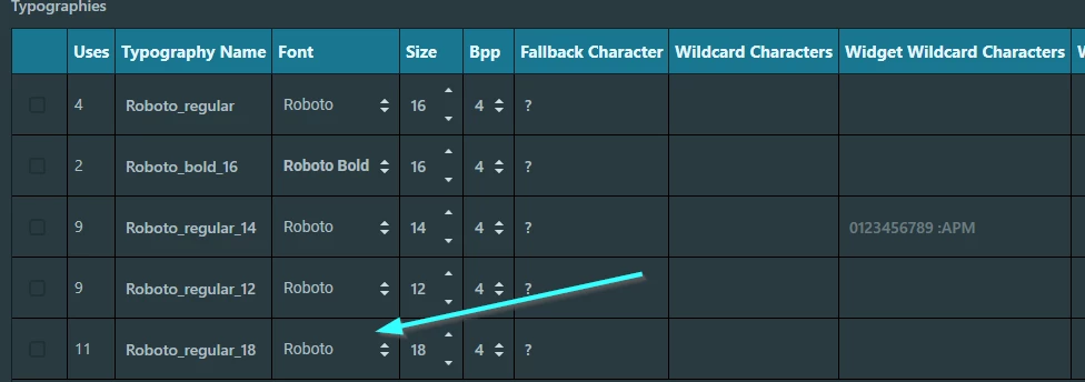

0693W00000GXQ6oQAH.png0693W00000GXQ4TQAX.pngQ: Is the simulator Locale configured to GB?
A: Yes. I think so.0693W00000GXQ7IQAX.pngQ: Do the fonts exist?
A: Yes. I think so.
0693W00000GXQ8kQAH.png0693W00000GXQ86QAH.pngQ: Has the code been generated properly?
A: Difficult to tell, but I see the text initialisation
