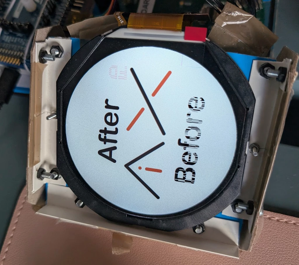

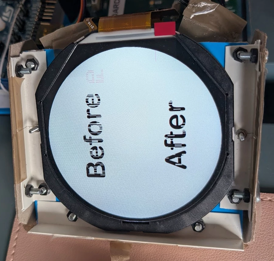

TouchGFX seems to have some sort of a “bug”, where in PORTRAIT orientation the text will glitch with some weird white lines, unless there is an image in the item-tree situated ABOVE text items. It doesn’t have to be any image in particular, but MUST be an image.
If there isn't any image added, then every text element is glitched the moment I rotate to PORTRAIT:
touchgfx::HAL::getInstance()->setDisplayOrientation(isPortrait ? touchgfx::ORIENTATION_PORTRAIT : touchgfx::ORIENTATION_LANDSCAPE);
The glitched text looks as such (see the white weird lines corrupting the text):
This is my item tree in TouchGFX Designer (I also tried removing the background but the white lines remained):

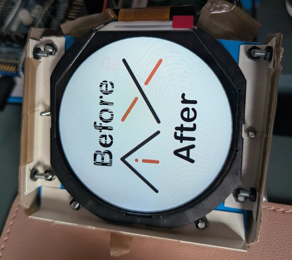

Then, if I add any kind of image, any text area under that image in the designer stack-up, it will be displayed without glitches and any text area placed above will glitch as such (Note, the XY location in the screen does not affect this, only the stack-up arrangement!):
This is the stack-up to produce such result.
Note that the text 'Before' can be moved anywhere on the XY location on the screen and it will still glitch, whereas the text 'After' will not glitch. If I move both 'Before' and 'After' to be under the image1 in the stack-up, both text items will be glitch free :)
Is there a known cause for this bug, can anyone else reproduce this? I am ok to have a workaround I posted here, however it feels more like a workaround rather than a solution.

I was unable to reproduce the issue on my side. Could you give more info about your project? Which STM32 MCU do you use? Which version of TouchGFX designer do you use? Have you switched orientation of the text as well as the display orientation?

Setting display orientation in TouchGFX at runtime is not supported, it relies on assets to be generated "rotated" at compile time. If you need your UI rotated at all times, you should set the option in Designer under Config -> display.
If you need rotation at runtime, you can either duplicate each screen with a rotated version and work around it that way, or you can rotate the framebuffer contents. This thread has an example that shows how to accelerate a rotation of 180 degrees using the GPU, you might be able to get some inspiration from that.
