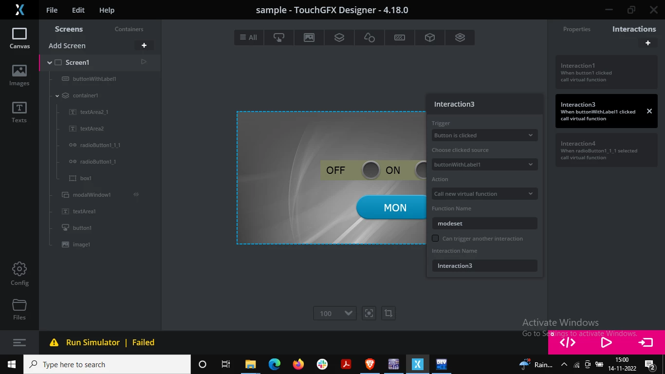

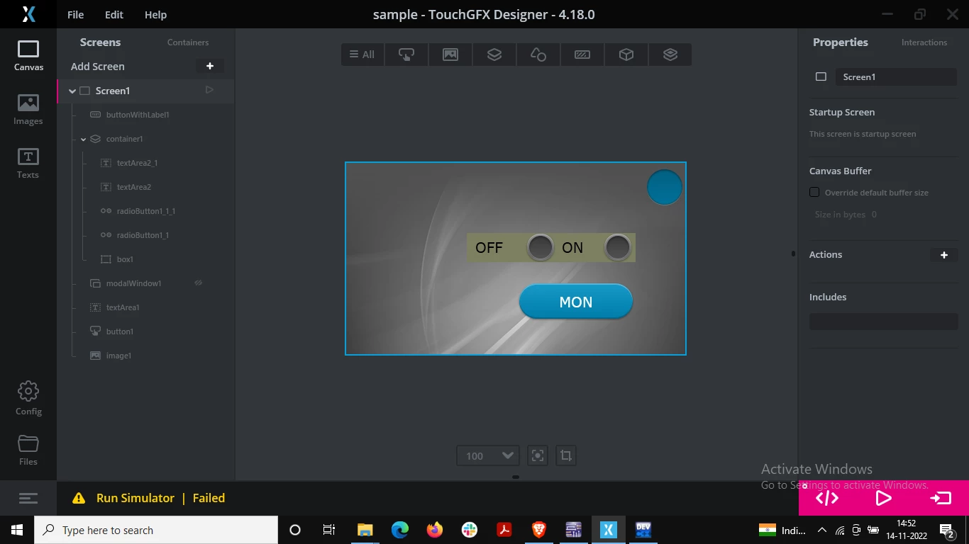

i simply create a application with a label button, container with two radio button shown below
actually what i want is when i click the button show the container (do it with interaction and virtual function calling)
container.setvisible(true)
container.invalidate
works well

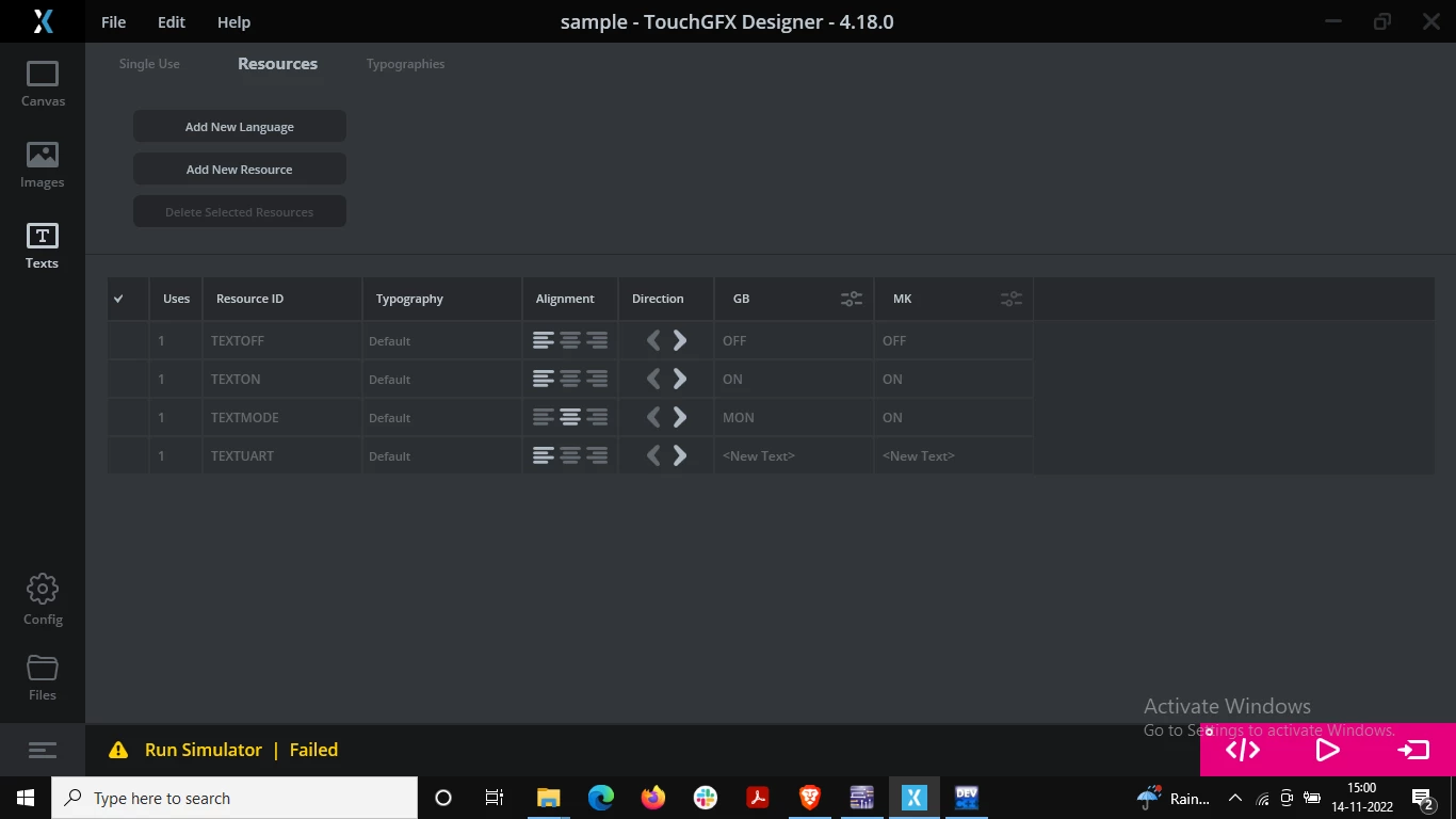

at the same time when i select any of the radiobutton ,the text of the label button have to change corresponds to the resources added (do the same in touch gfx text example)

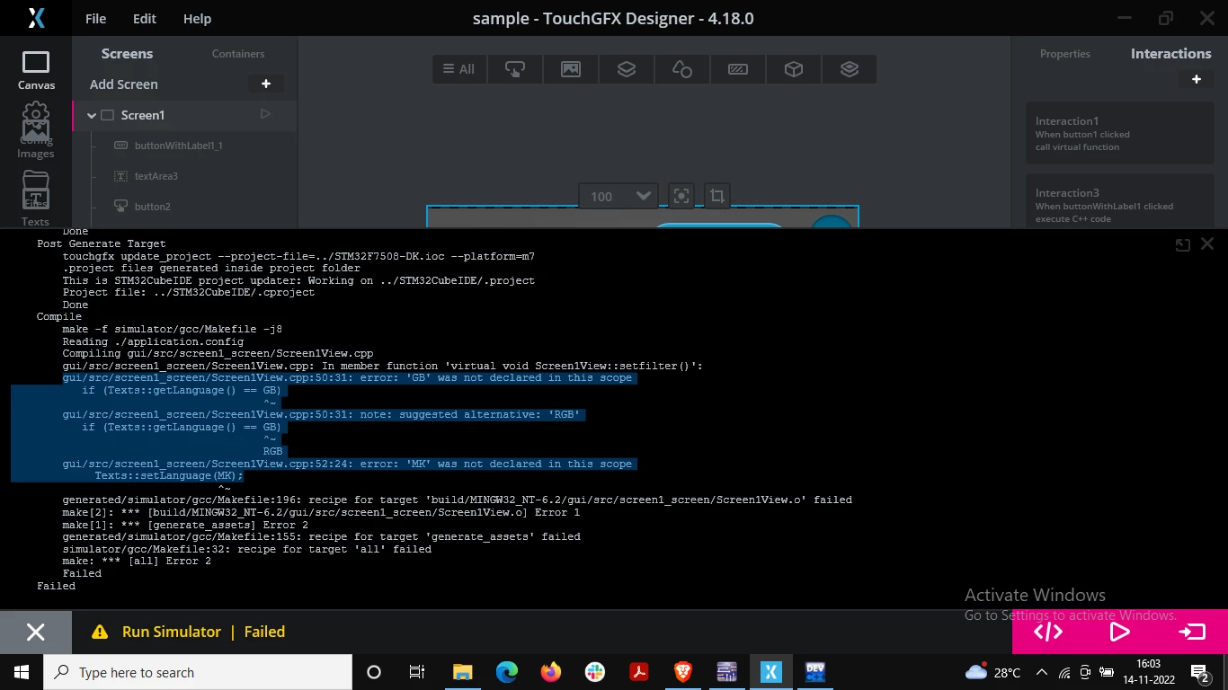

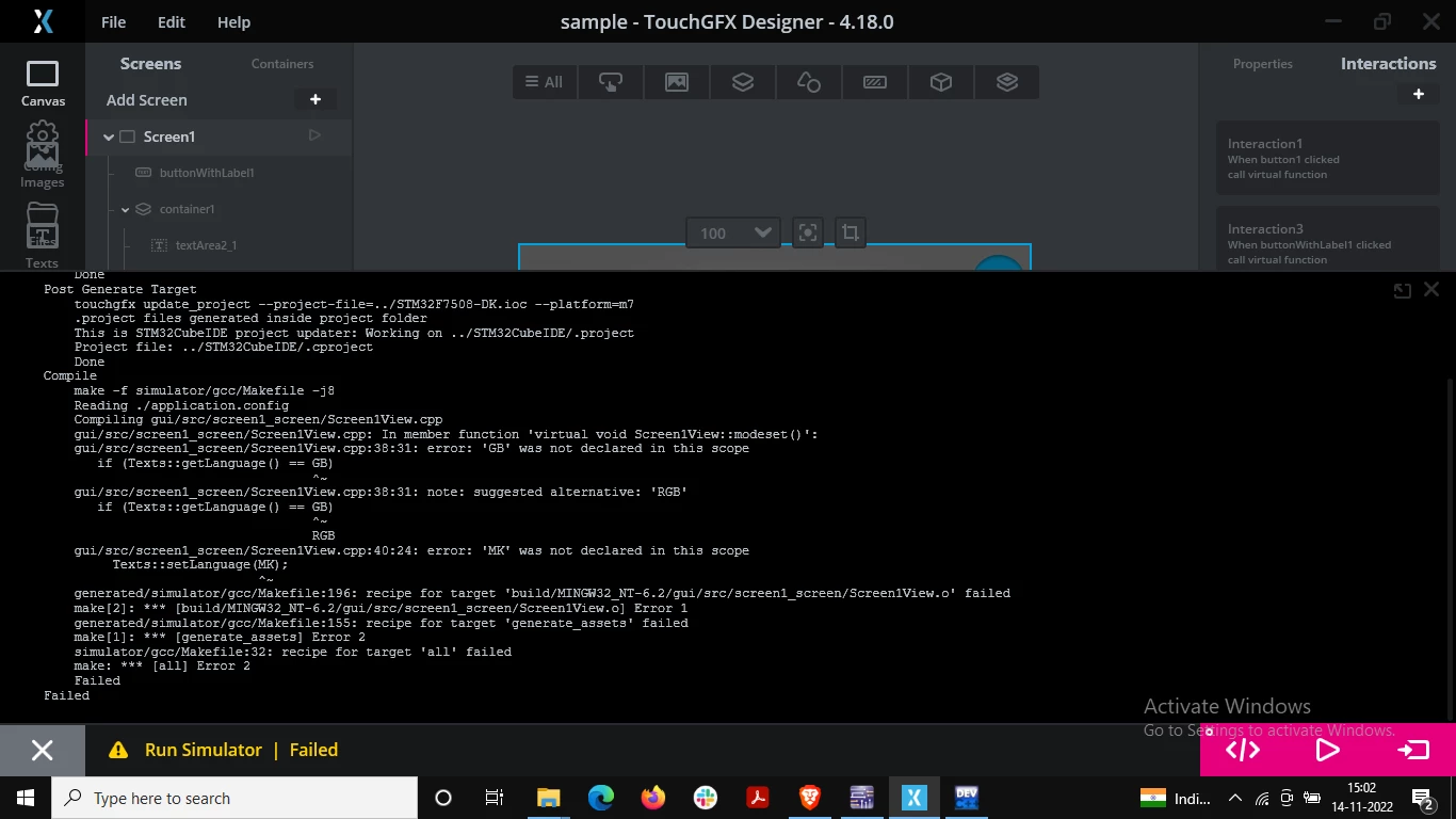

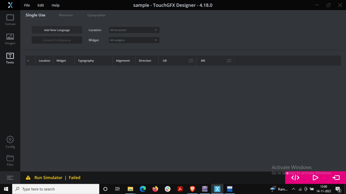

something shows like GB was not declare in this scope
dont understand what it mean

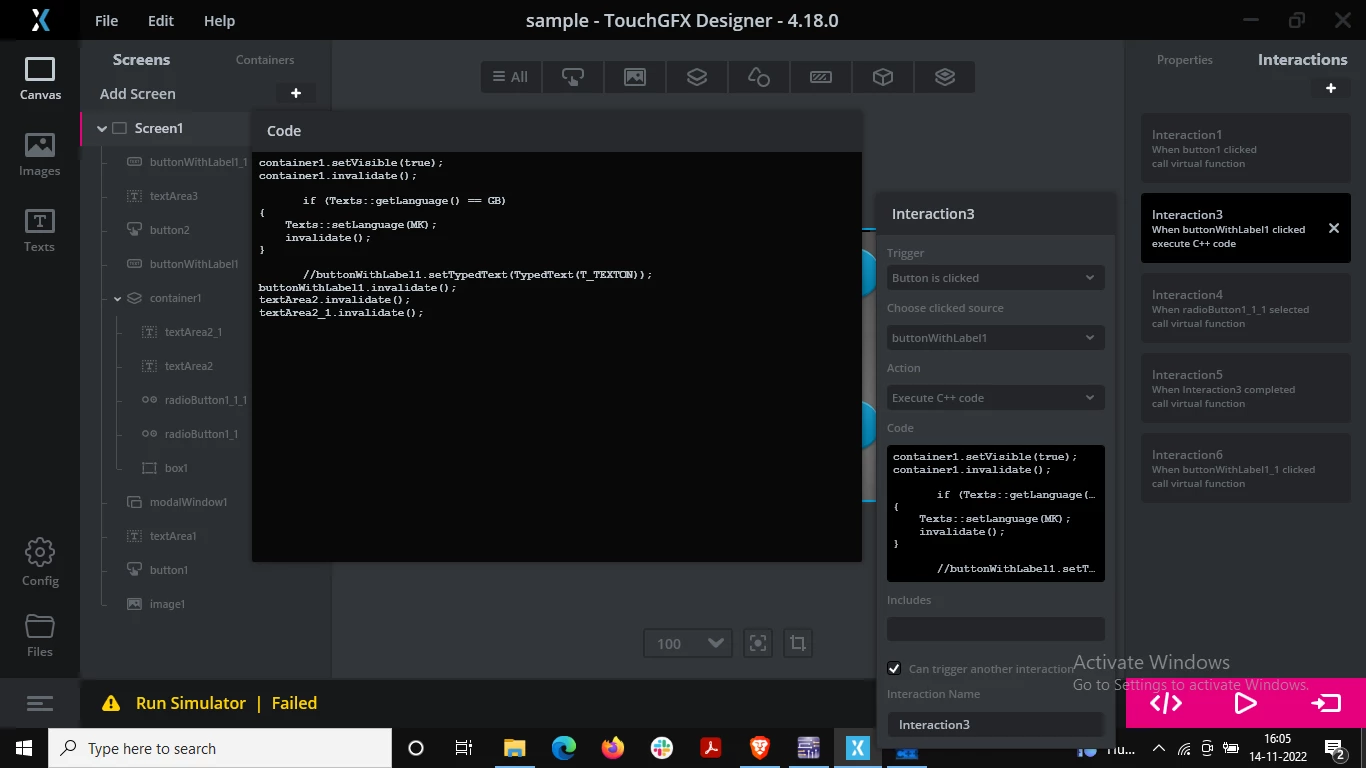

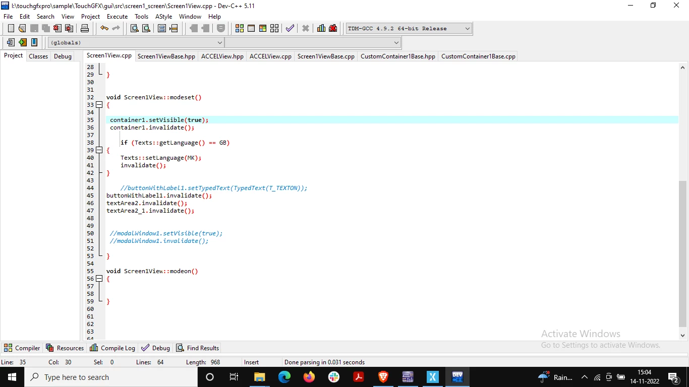

code
MA.21
MA.21Author
Nov 14, 2022 10:34 AM UTC
i include c++ code when lebel buton clicked and run simulator its working, but i call new virtual function when button clicked(shown above) and copy the same line in c++ code doen't work it shows GB OR MK not declared in this scope0693W00000WIFrsQAH.png
how i can fix

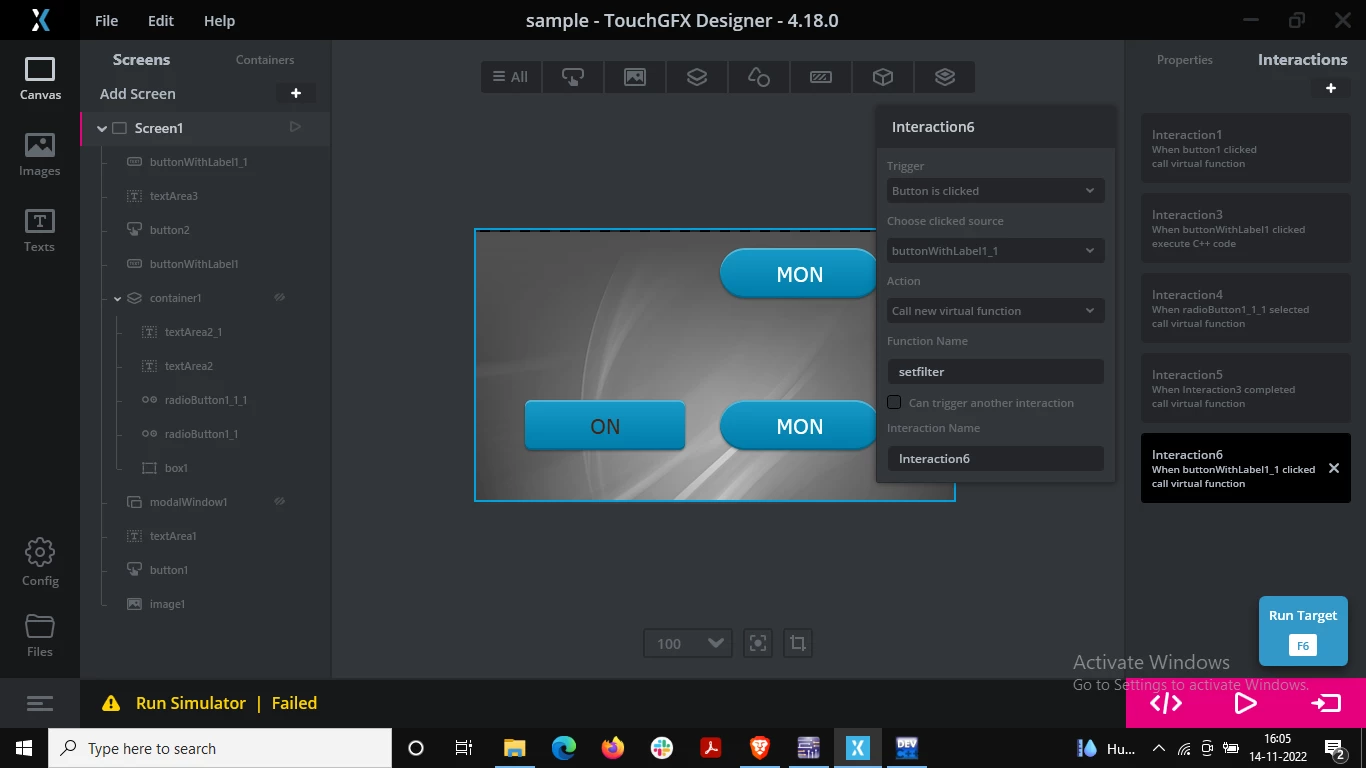

ineractions
it works fine
Osman SOYKURT
Nov 16, 2022 2:13 PM UTC
Hello @MA.2​ ,
I think what's missing is the correct include.
#include <texts/TextKeysAndLanguages.hpp>
/Osman
