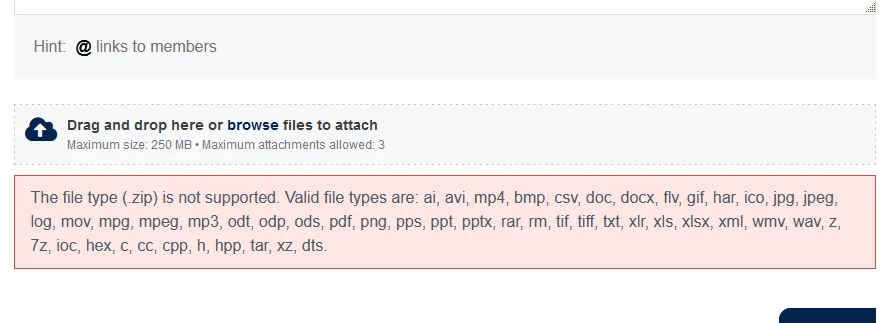

ferro
Lead
Jul 8, 2024 2:58 PM UTC
Hi @GaetanGodart
Do you know why my .zip file attachments are refused by forum ? Thanks.
GaetanGodart
Jul 8, 2024 3:37 PM UTC
Hello @ferro ,
The ".zip" extension is not supported. Most people use the ".7z" extension to share their files.
Regards,
Gaetan GodartSoftware engineer at ST (TouchGFX)

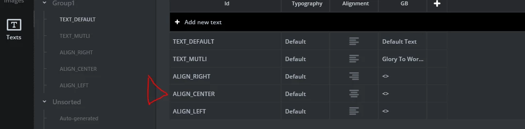

Lead
Nov 27, 2024 3:54 PM UTC
1. missing
#include <texts/TextKeysAndLanguages.hpp>
2. or ALIGN_CENTER is missing in Text view:
If not then past here compiler error screenshot please
NGune.1
Nov 27, 2024 4:05 PM UTC
Hi Ferro,
Number 2 was missing.
I added a new group, "ResourceID2" and made it center_aligned in the Designer. And then i my code wrote:
Line[i][j].setTypedText(touchgfx::TypedText(T_RESOURCEID2));
Everything with this ResourceId2 is now centered.
