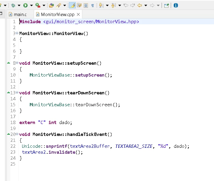

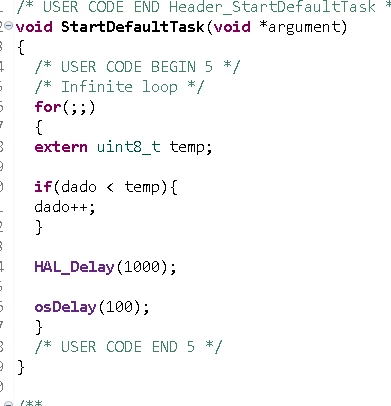

Hello everyone, I hope you can help me!!!
I'm at the beginning of programming in C++, and I'm having difficulty taking a variable from my main.c file to my screen created in touch gfx.
This error appears, where it apparently does not find the variable declaration.

build/MINGW32_NT-6.2/gui/src/monitor_screen/MonitorView.o: In function `ZN11MonitorView15handleTickEventEv':
C:\TouchGFXProjects\MyApplication_2\TouchGFX/gui/src/monitor_screen/MonitorView.cpp:22: undefined reference to `dado'
collect2.exe: error: ld returned 1 exit status
generated/simulator/gcc/Makefile:160: recipe for target 'build/bin/simulator.exe' failed

I followed what the course instructor said, but apparently it doesn't work.

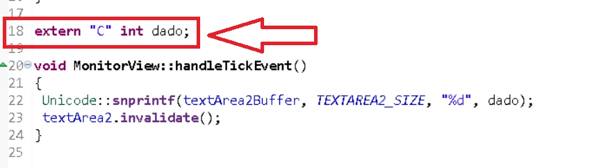

I am not sure the value "dado" is in other .c file (ex : in main.c)
If yes, you can try modify line 18 to "extern int dado;"

Hi, I removed the "C" and recompiled, but the same error appeared, I'm trying to backend an analog reading in main.c to the screen, I'm going to send the more simplified file of the project.

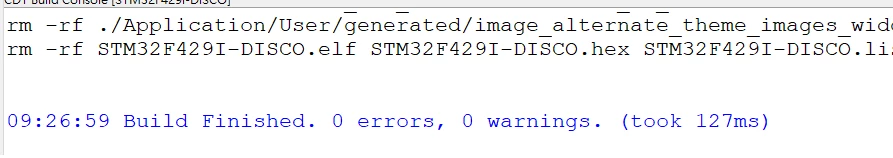

Sep 5, 2024 1:50 AM UTC
I can build your project in STM32CubeIDE 1.16.0 with touchGFX 4.24.0. Did you try to reinstall them ?
